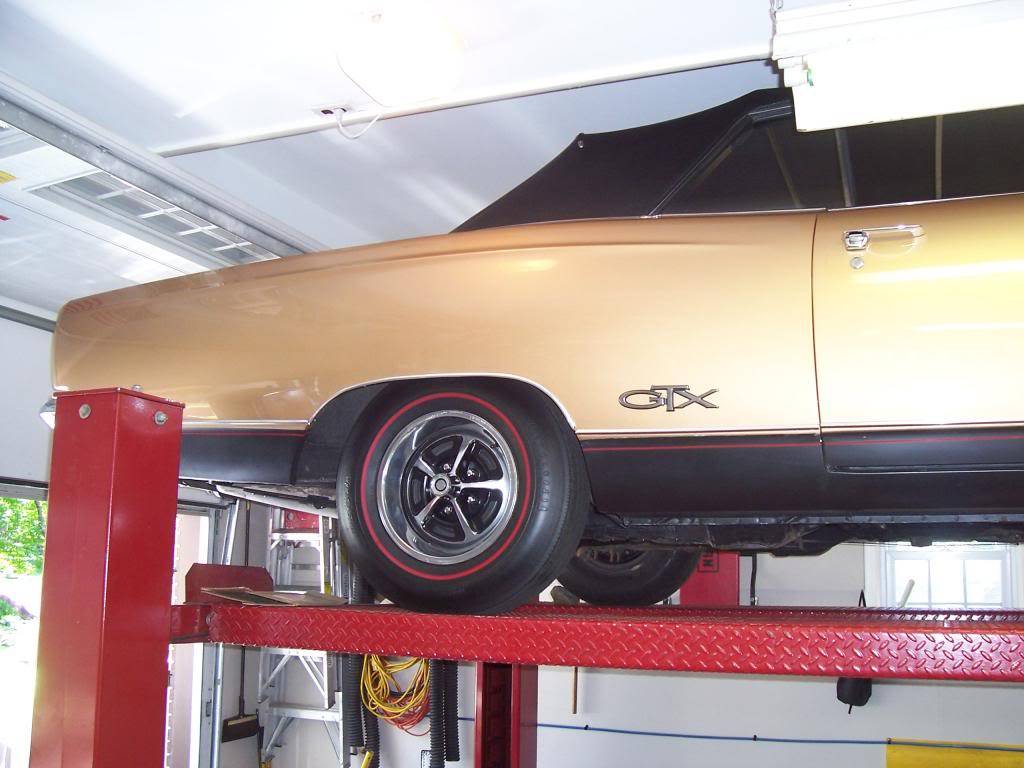

Was the pin stripe on the blacked out area on 1969 GTX's a reflective stripe? I've heard that the white was while the red was not. Our car has the red stripe on it and from talking to the third owner, that stripe was never removed and does not appear to have ever been messed with. The red stripe that is currently on the car is NOT reflective either. Would any one know what the original thickness of the pin stripe was? Also, any confirmation if they were reflective or not would be appreciated as we are getting ready to repaint the lower blacked out area on the GTX.
Thanks,
Brian
According to my book, it was originally a piece of 3M reflective tape, either red or white.
The book I referenced that off of was the Paul Herd "Charger, Roadrunner, SuperBee Restoration Guide". I have a few books books I reference off of and if I am in doubt ever, I always come here. And just to make clear, that is the thin stripe I am talking about, not the stripe molding in case there was any confusion there.

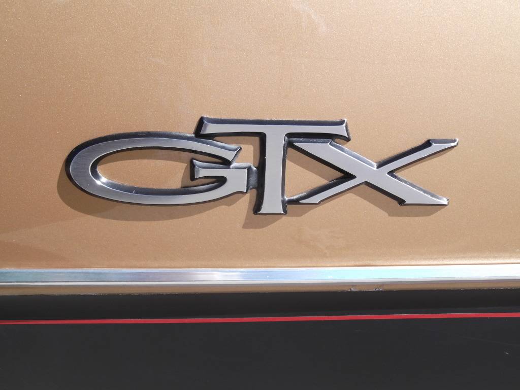

Correct, this is the thin approx. 1/8" stripe just below the body molding and in the blacked out area on the bottom of the car. (as seen here)

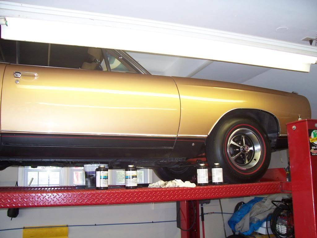

more pics.

So does the white have a silver reflective appearance and white when it is not reflective? I'm sanding down the lower blacked out areas now and am now finding pieces of the original white pin stripe in the edges of the car. I have found Scotchcal as white/silver.
