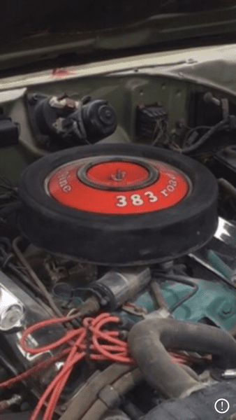

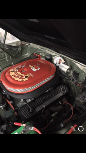

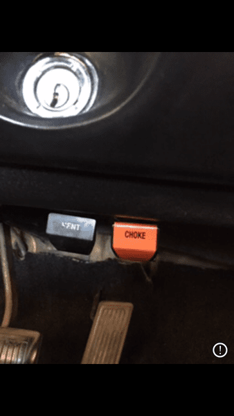

the 68 roadrunner with a hemi came with manual choke found it on line , cant remember where exactly but was inexpensive and I put hole about 3/8 inch with a rubber grommet , the factory placement was too hard to get to covered by the heater box and would put a bind on the cable I put it through the slanted part a little below the wiper motor , I cant get you a pic right now my car is at my other house 90 miles away, I'm going up this weekend and will try to remember to take a picture for you
thank you !! i was hoping for a factory location since i really hate to drill into a body because the late owner tried to make everything as correct as possible. thats the same reason i have not added a TAC yet. i will bee if i can find a hole near the heater box where there might have been one added years ago. thank you for the pictures it helped alot.
No it didn’t. A 1968 hemi roadrunner came with an automatic choke. There is no cable Coming through the firewall. The factory service manual will show the thermostatic choke on the side of the rear carb. Also the choke heat tubes and flapper valve in the exhaust manifold.
Why are you spreading false information here? Or do you just not know this?
The first and only street hemi with a manual choke cable was all 1971 street hemi cars.
where do you have the cable going threw the fire wall and where did you find the chock knob at? i didnt know they had a factory manual chock
The only factory manual choke I’m aware of was 62-64 max wedge and 1971 street hemi. Never on a single 4bbl or 2bbl Passenger car. Can you imagine all the Warranty problems with all the idiots trying to get their car started.

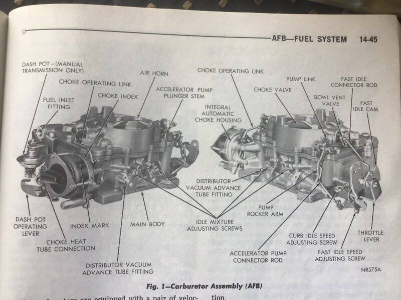

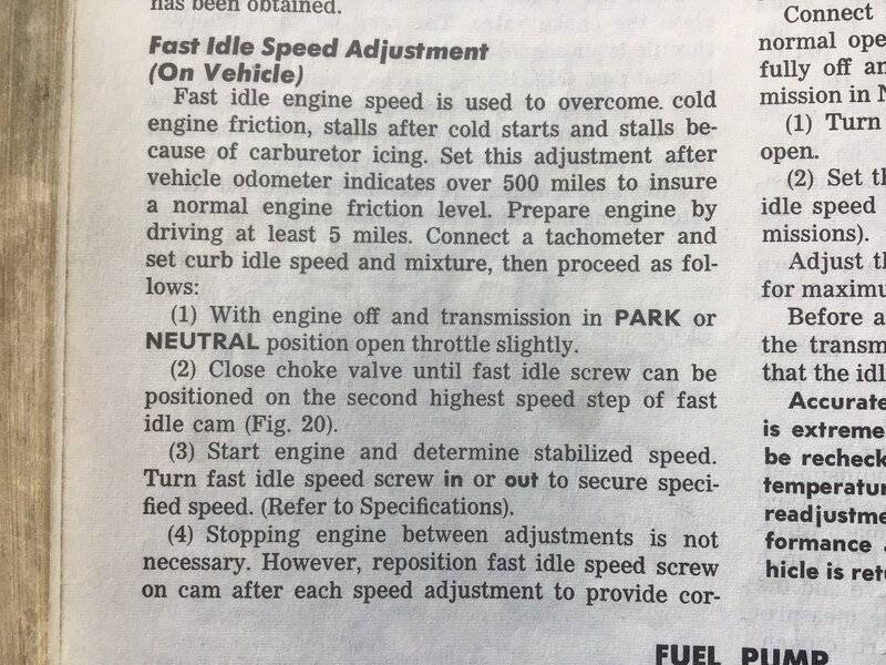

Look in a Factory service manual and it shows the Automatic choke in there. 426 street hemi automatic choke.
C467A48E-CEE8-4DB5-AAE3-6DAA15020F13.jpeg 80C81F31-3FB2-4381-81C5-00326CC08F24.jpeg 8B27BCE4-91AC-4624-A651-EB40A34147F0.jpeg
i will have to do research on it to see if i can find the parts and also how the heat tube hooks up. thank you for looking it up for me!

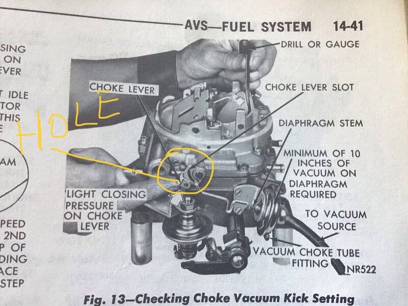

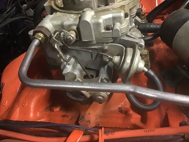

Your 440 GTX With the AVS would have a choke thermostat bolted to the intake manifold and a choke vacuum diaphragm on the carb, which partially opens the choke when the engine starts. Common name is a choke pull off.
I have drawn a Yellow line to where the choke rod connects to the carburetor.
the engine posted is a 1970 but same hook up and choke diaphragm
8718895E-757E-471B-9B38-BF41936ABAA6.jpeg 8ADEC39A-3B6F-40EA-A268-2D7A53EEC082.jpeg 6C78F81E-3212-4CC5-9C6B-0785B482AA1B.jpeg
thats the piece i have been trying to loosen so i could put it on an eddy carb. they must have used locktite on it because the retaining screw will not loosen. by any chance do you know if its left handed threads like some lug nuts? :)
