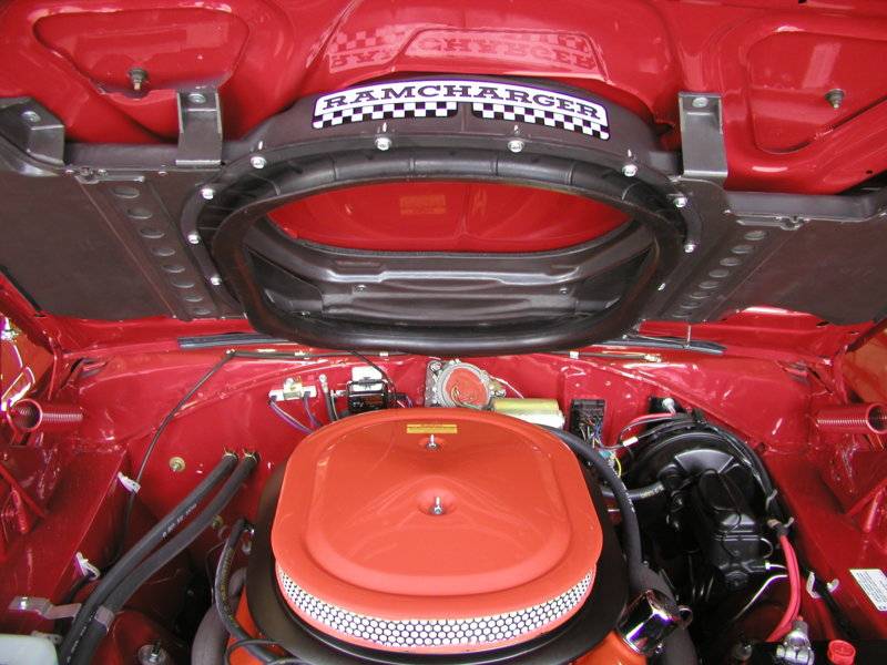

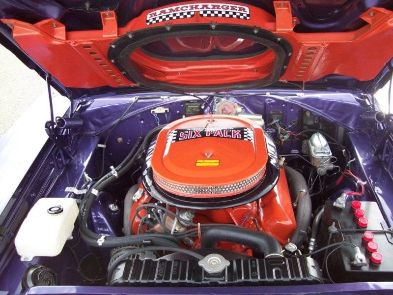

I'm building/restoring a 69 ramcharger air box for a n96 hood. I've seen ads for hardware. They typically have the screws, unuts, and rivets. But the few i've seen in person had bolts holding them to the hood as well. Are the bolts correct ? Or are they a replacement for the rivets ? Also, all the pics i've seen are too fuzzy when blown up, to tell which go where. If someone could post a pic or explain what hardware ia used where, i'd be very thankful !

'69 should be rivets to the hood, as shown below. Don't know about '70's, don't own one.
Would you believe rivets and screws both? Screws are on the side edges closest to the fenders.
Yes, it was the bolt thing that threw me. I didn't realise bolts were for 70. None of the hardware kits i've seen had bolts. Also some kits have 10 rivets, some have 12.

I believe that you are correct, with the exception of the indentation on the driver's side of airbox for clearance of the brake M/C on HEMI cars.
