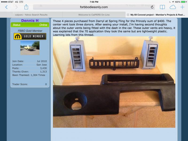

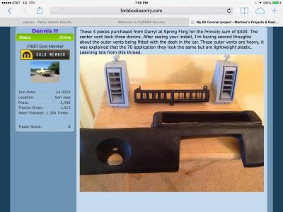

Not yet, but I bought the required parts a few years ago at Spring Fling. $400 for the vents including the center pad surround. Everything works. Bought a box on FBBO to plumb it. Planning on the job getting done when the dash wiring gets replaced. These are hard to find and pricy items. The vents took three donors to put together a working one. Got them from a guy name Darryl in the California desert. I can post pics and his info later if you need it. Good luck. Get your wallet. I have Classic Autos Air out of Tampa. The vents are cheesy, but the system has been ice cold for 9 years.
