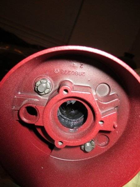

Remove the 2 hex nuts.....To remove/install refer to this thread

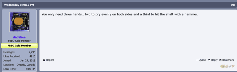

You only need three hands.. two to pry evenly on both sides and a third to hit the shaft with a hammer.
If you hit it hard enough... but while prying up on the collar, a light rap with a hammer would likely help the bearing let go.

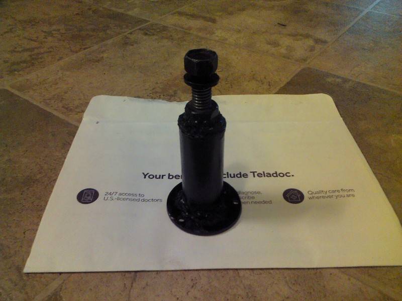

Lord knows I would pay premium price for a Miller C-4044 removal tool or a home made version at this point.
I have one......if you cover postage I can send it to you......or I can send you the dimensions and you can make one...
Thank you very much for the offer moparnation74! I had the day off and went to Harbor Freight and bought the cheap mig welder then fabbed one up and it did the job for me.
I am at a loss as to how these two nuts and weird head screws serve a purpose. On my hub the nuts were just threaded on to the weird screws that were seated in their recesses and nothing in between. ???
The bolts fit in the slot in the column. Which in turns hold the hub in place. It’s in my thread in the restoration section. Go to page one and click the link to the restoration tool and then select the heading for steering column..
Yes, thank you, I saw that before I commented and I wonder how much I will miss them if I leave them out. I'm not sure but seems to me they might not be such critical bolts on a floor shifted transmission. Just wondering. I think it might be easier to assemble if the column were out of the car but its still in. Anyway, I will let you know how it goes.

Show me where where I stated screwdriver?
You didn't say anything nor disagreed with this post below...I guess a hammer cant do as much damage as a screwdriver:
