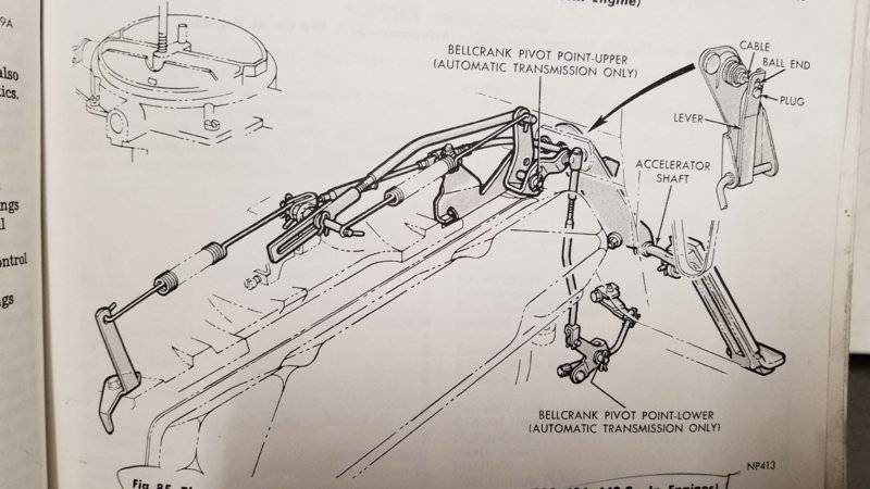

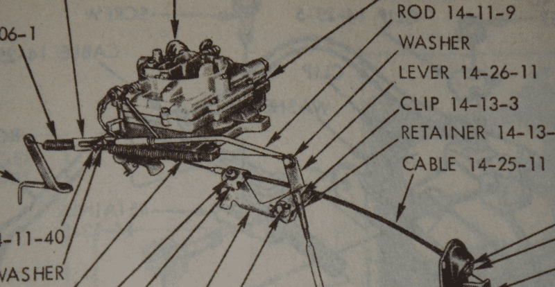

Need someone to tell me or post pics of what should be on a 69 road runner. And....this also has a 440 4 bbl in it instead of a 383. It also has a Demon carb and an Eddy RPM intake. The stuff on it already looks like a cluster fork and would like to make it more closer to right without having to cob up original parts and make the trans shift right.

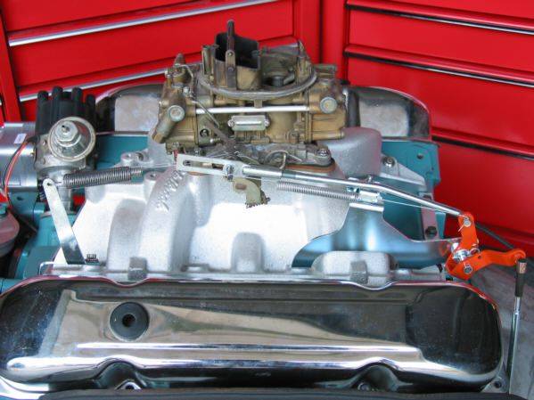

Here's one using Mancini's tall brackets
A picture from my old Koller Resto book if it helps...………
If you're planning to stick with the rod style kick-down (and not go Lokar) you'll also need an extension on the intermediate rod. Edelbrock part # 8003.
