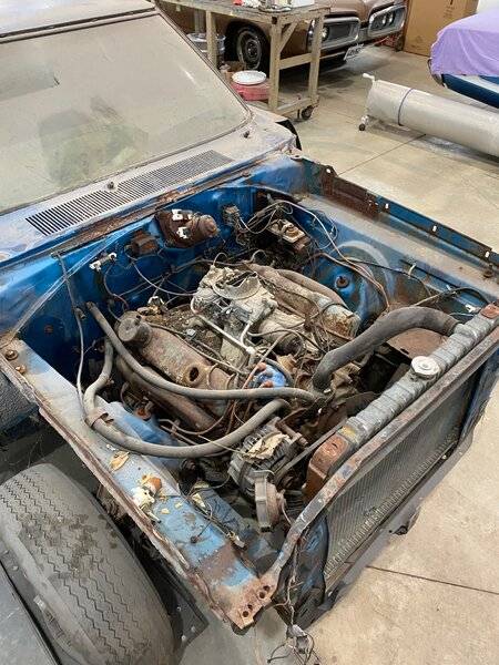

After finishing the 70 Bee tribute car earlier this year, it’s now time to start on the next project. I bought this roadrunner a few years back from an older gentleman who had it stored outside for several years. He had originally planned on fixing it up, but never got around to it.

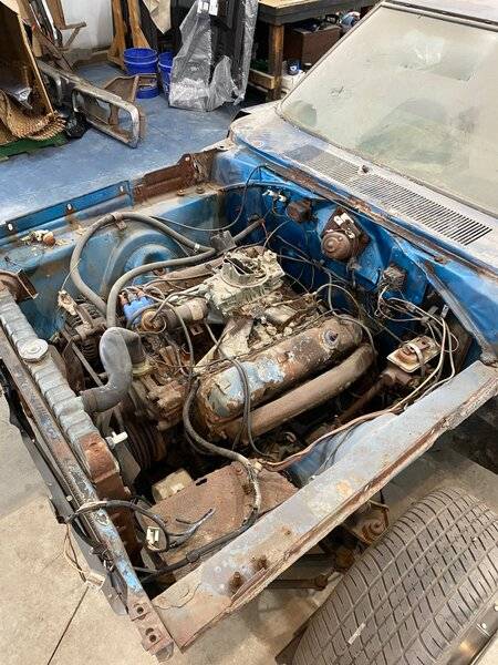

We knew it was rough when we looked at it, but the price was right. Car was missing both front fenders, but hood was repainted and stored away along with trunk lid in etch primer. Originally a B5/B5 383 N96 car with auto transmission. Not sure if engine and tranny are original until we tear it out and inspect numbers.

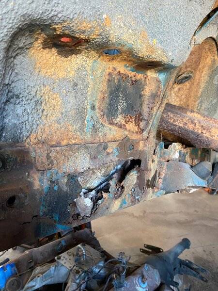

Front driver side frame rail is toast.
Not sure why someone cut trunk floor out above fuel tank either. Must have been at same time they cut out quarters above wheel wells too.

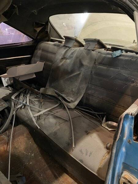

And a couple pics of toasted interior.
Looks like a lot of the misc trim is still with car which helps, but every piece of sheet metal likely needs replaced. The driver side door and possibly roof skin may be salvageable, but time will tell. Over the past few years I’ve been picking up new metal when I find it, either by someone who had new metal and didn’t use it or buying new myself. I already have full quarters, trunk floor, extensions, floor pans and outer wheel houses. I also bought a set of original fenders via an online local auction.

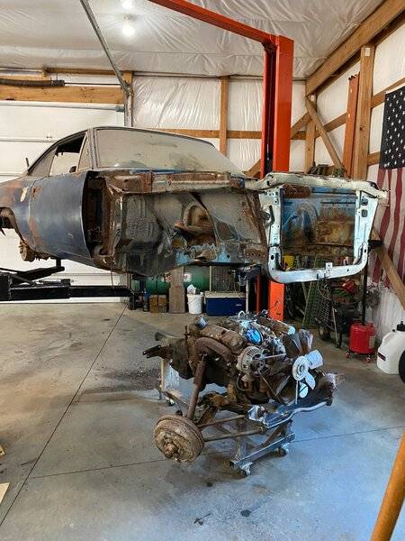

With my brothers help, we got the front drivetrain out today.
Confirmed it didn’t have original engine. It had a 400 in it, not sure what year though. Bell housing on tranny is junk as it several pieces broken off.
I was hoping just the section in front of shock tower on driver frame rail needed replaced, but after getting engine out the rot goes back nearly to firewall. I believe I have a replacement already from a 70 coronet parts car we tore down a few years back.
Passenger front frame rail looks solid, but inner fender needs replaced as she was hit hard sometime in the past and is wrinkled. Might have been able to hammer back into shape, but the torched a large area behind hood hinge as well so I’ll just replace it.
