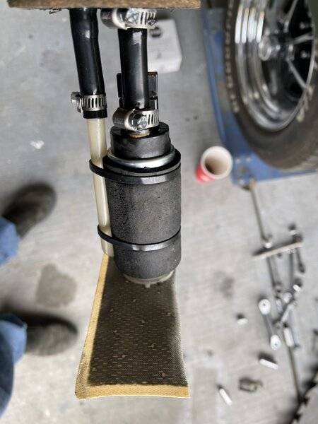

And our findings when the tank dropped & pump pulled
that prefilter will look dark once it gets wet...looks normal to me
if it’s loud enough to hear over a mopar engine and exhaust swap it...especially since you have it out
watermelon
My pre-filter does not look black? Just a thought?
Test by placing pump in fuel jug (I use a 5-gallon Fuel jug) without the pre-filter and see if it pumps fuel (into another fuel jug or gas tank) and still makes the noise.
Then test with the pre-filter on?
Problem resolved... clean tank, new pump and filter. Good to go... the 493" so far is liking the extra fuel rather than being starved for it. Now if mother nature would cooperate I could really test her out.
