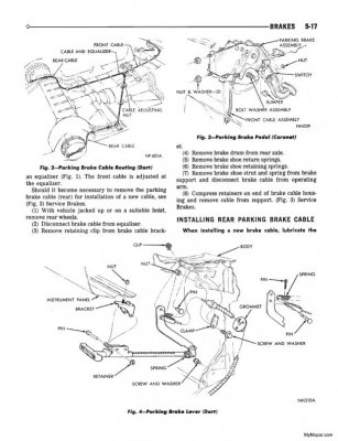

Helping a friend with his 69 RR. Would anyone have a picture of the emergency brake mechanism? My friends seems to be missing a spring and bracket on it but we wanted to compare his with a picture.

RR would be the same as a Coronet

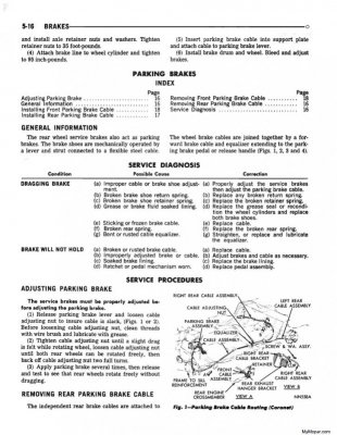

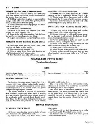

Thanks for the picture 69Bee. We have the FSM. Looking at the mechanism in the FSM, we need a shot of inside looking out from the picture, if that makes sense. He is missing some kind of bracket and or hardware holding the emergency brake cable to the mechanism.
I will look at my pics when I get home to see if I can determine how it attached, but I think it was just a clevis pin.
Here are the 2 pieces you need to hold the cable and fasten it to the park brake pedal assembly. I have some of them on e-bay but you can PM me if you need them for a much better sold directly to member price. The clevis is made right on your front cable assembly so you should not need that but if you are making your own front cable i also have the clevis available here if you need it
