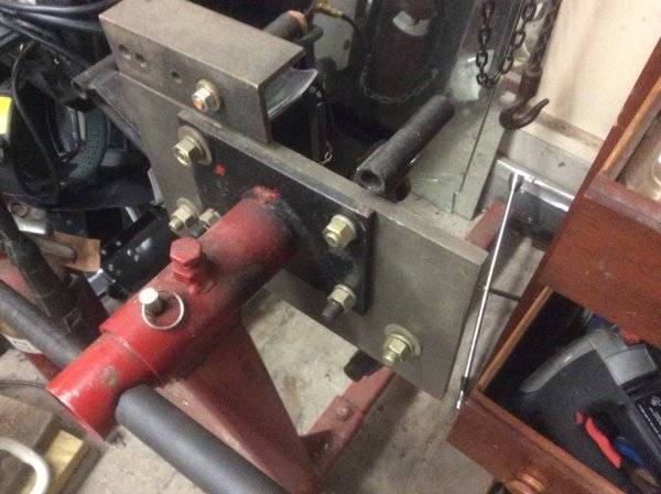

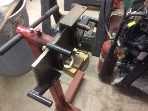

When you look for an engine stand be sure it will span span of arms that hold engine will open wide enough. Bought a stand mail order and had to add a new face plate.

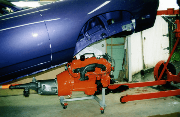

Build yourself a 3-point trolley with steerable wheels, and hire an engine lifter (to lift the body). You will need to jack up the car first to unhitch some items, but this is far easier than taking the engine out from the top.....and you can detail all the front end at the same time. This is how I assembled my car after paint - however the next time it came out I had access to a full size 2-post hoist.
This is what I had to do to get it to hold a BB.
Bracket on 1 arm for another project.

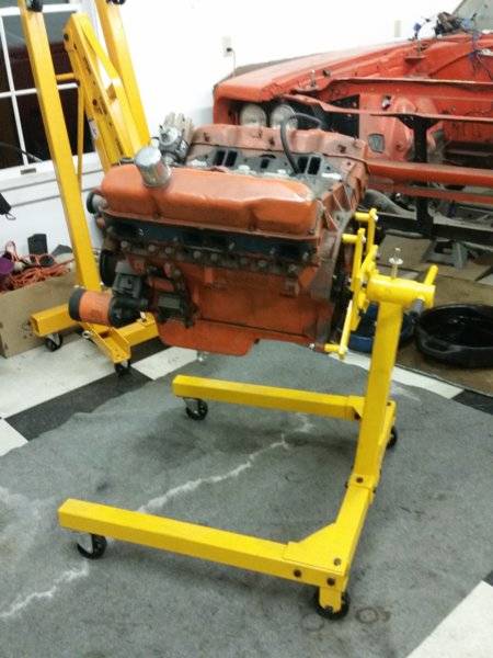

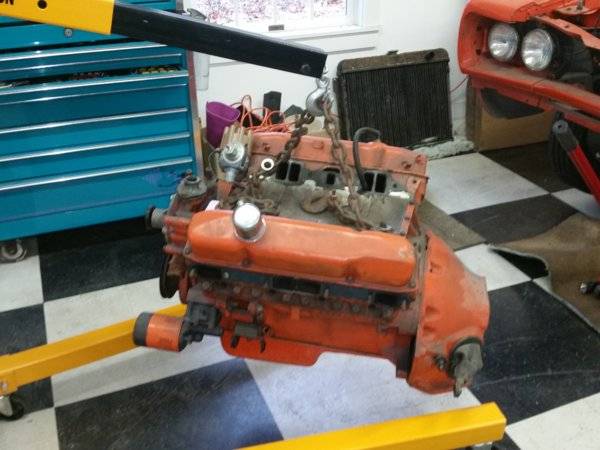

To ksurfer2... I've done this job maybe 8 times and it's not all that tough, just time consuming. A good hoist & engine stand can hold a 440 BUT I have always tried to have the cherry picker chained to the nose of the engine once I start putting on all the accessories...just to be safe.

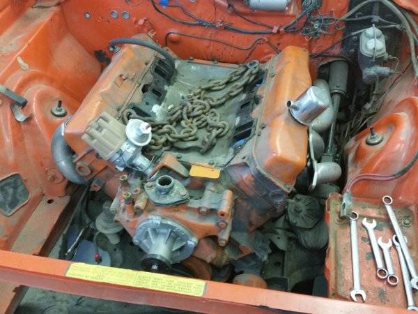

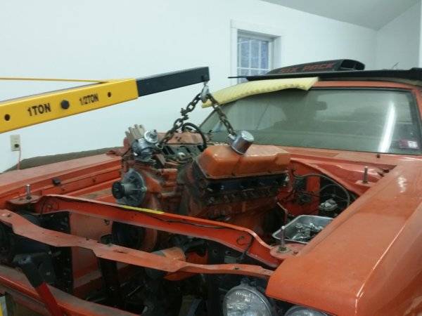

1. I've always pulled motors out the top with the hood off.
2. Watch for garage roof clearance since the hoist will be a couple feet higher than the engine, which will be higher than the fender.
3. I prefer to install the "long block" (block/heads/oil pan) & bolt the intake & accessories in after the motor is bolted up. It's less weight for the hoist. Also, I personally like to lift the engine by two diagonal intake bolts (intake off). I've seen many people do it, but I don't trust the smaller carburetor bolts on the intake to lift the motor (too small, ESPECIALLY with an aluminum intake)
4. If you have headers, lay them in place & position the starter in its "header cage" before you set the motor completely in the engine compartment. If no headers, the starter can go in later.
5. Definitely remove the radiator & a/c condenser so you don't smack it.
6. Removing the water pump & accessories before pulling the motor gives you extra clearance. This is also why I like to put those back on after the motor is installed.
7. Once the motor is bolted to the motor mounts, I personally like to let it hang down a little bit, maybe with some blocks of wood in back, to make it easier to install the transmission.
8. Take your time & be safe. Until the trans & motor are bolted together + the motor mounts & transmission cross member is installed it could fall.... after those are in, you're completely safe. Also, make SURE to have the car up on very sturdy jack stands, higher up in the front. I like to remove the radiator & accessories on the ground, THEN jack up the car.

Right on PurpleBeeper. That's all good advise and almost exactly how I pulled the 440 from my A12 without any trouble at all...
