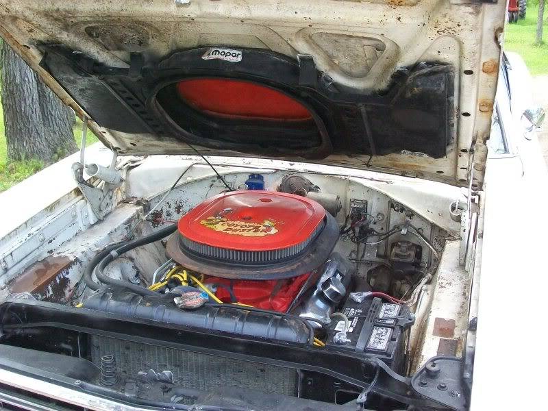

Yes. We were surprised to find the BS in relatively good shape. Even more surprised to find the second tag laying under the rear carpet. It is in fact a bucket seat, buddy, with a 6 way. I think its a cool car. I dont know the late 60's fender decoding cars too well so thats why I posted it here, looking for help. Anyone have the dimensions for the stripe? Also, the N96 code is in fact for air grabber? Therefore the hood should have the tunnel for it, correct?

Yes it is an air grabber cars as indicated by the N96 code on the far right of line 9 of the BS.
You've seen the air grabber cowling (ductwork) for these right?
It should have this stuff riveted to the underside of the hood.
(mine, ugly but complete.
:grin:
