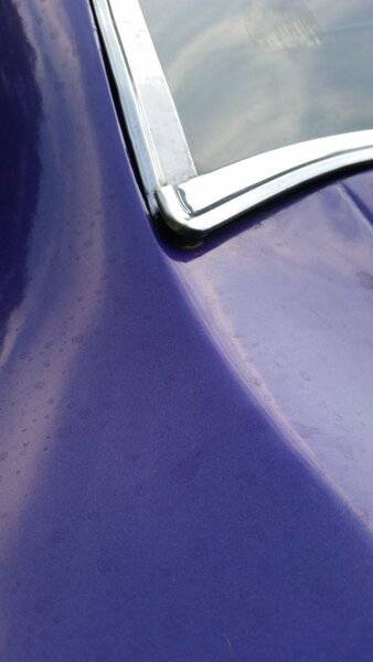

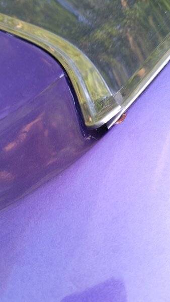

Any ideas what would be a good fix for this issue ?
VERY common issue. the only thing I can think of is pull off those pieces and replace the clips with new.
Can you replace the clips with the Glass in potion ?
No, the glass has to come out first. There aren't any clips right in the corners though. Maybe squirt some windshield caulk under the trim and weigh it down somehow overnight?
I have added clips before. Your trim is "tweaked". At least it is a glue in.
Doesn't the side pieces go over the top of the bottom trim at the corners?..........................MO
