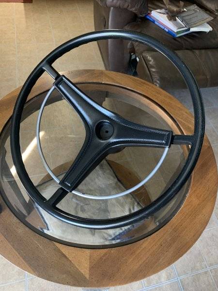

I am in need of replacing the steering wheel on my '69 RR. Does anyone have any recommendations as to where to purchase one from. I was looking at this one at PG Classics and wanted to see if anyone has purchased a wheel from them or if they had a better recommendation?

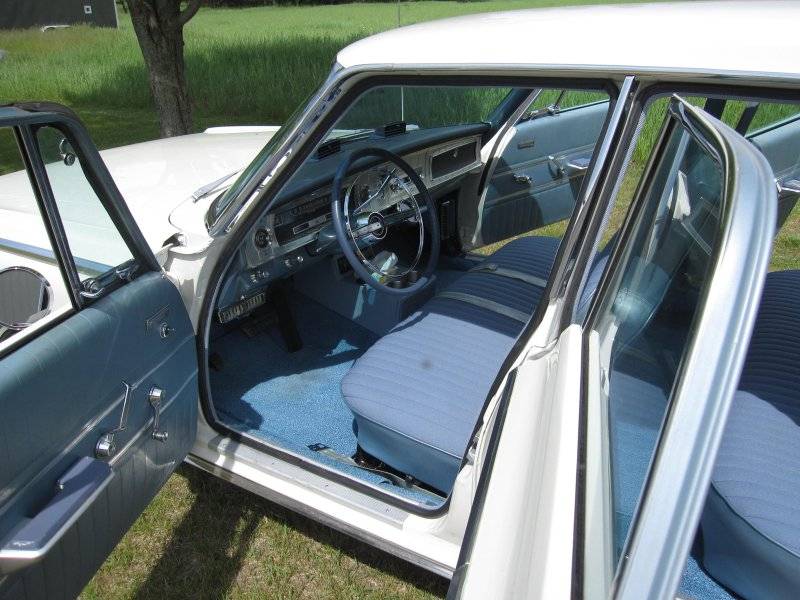

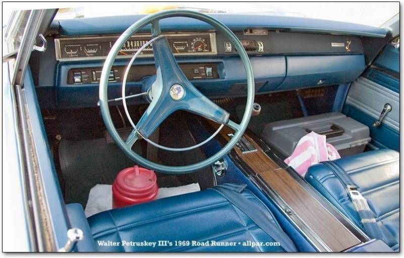

This is what my wheel style looks like and color. I only wish mine was in this good of condition.

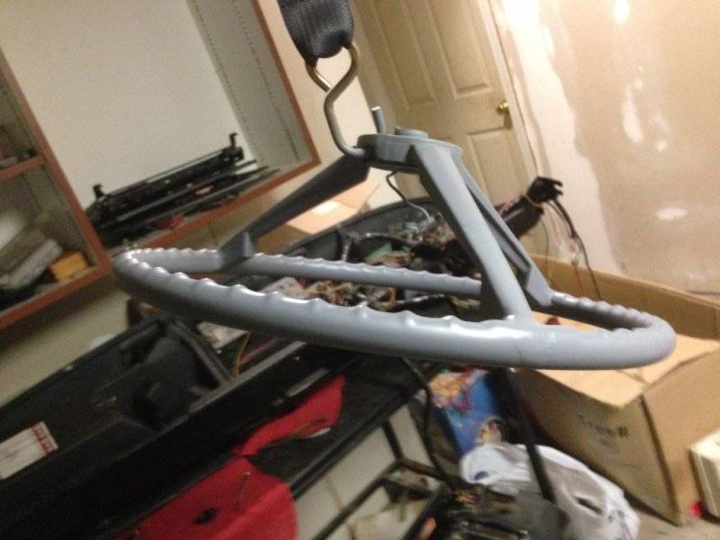

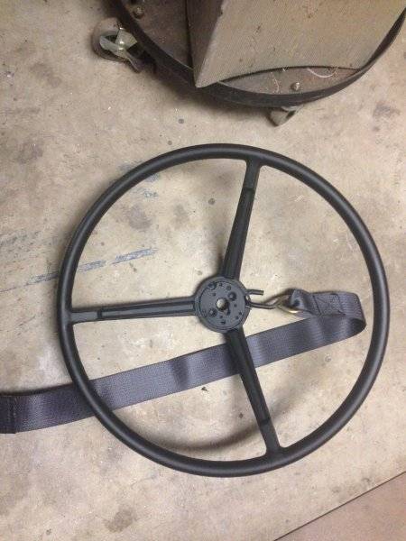

That is a simple style wheel. Repair it yourself, epoxy cracks, sand and paint it. Your local auto parts store should be able to mix the correct interior color and package it in a spray can. I did my 65 Coronet (first attempt) and it turned out fine. I went beyond and ordered a custom leather, lace on wrap in a matching color. The best photo I have on hand.

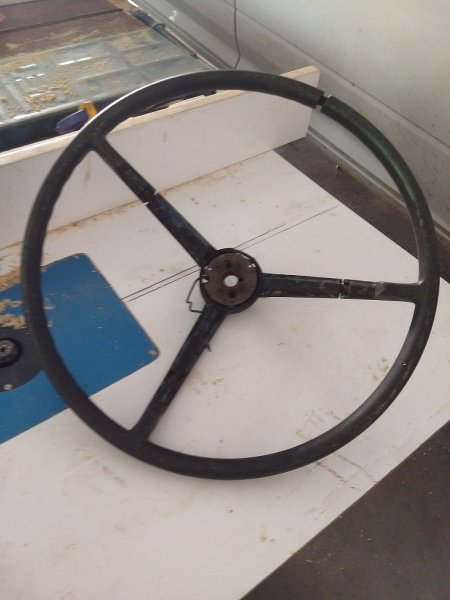

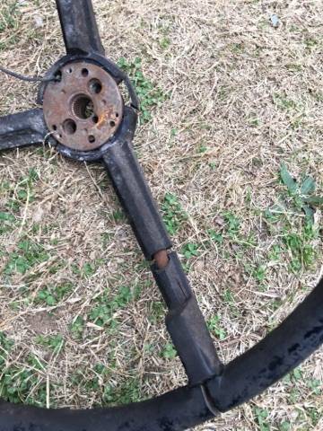

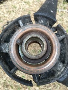

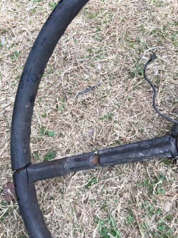

Here are some images of what the wheel looks like. As you can see it is in rough shape.
As far as redoing the wheel myself does anyone have any video recommendations that show someone doing it?
The one in the Roadrunner was in worse shape than yours. I used por15 putty and many hours of sanding and shaping but the end results are good. I'm your neighbor lol..
View attachment 1663882View attachment 1663885View attachment 1663886
View attachment 1663888View attachment 1663889
