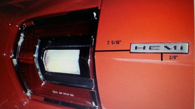

Anyone have the correct measurements for the pins of the Hemi emblem on the trunk?
Here is a 68. Hope this helps! Courtesy of Moparts.com.
I looked on Google Images and found that. I'll look again!
This is the best I can do! I found this pic on Google Images. If you want to,
you can put a measured grid over the pic and get the almost perfect location????
I am hoping someone has it laid out with the numbers already.
I know it's out there . . . Somewhere! Try looking on Moparts.com.
1969. On the inside of the trunk there are two little access holes for the nuts to be installed. You can use that as a guide.
