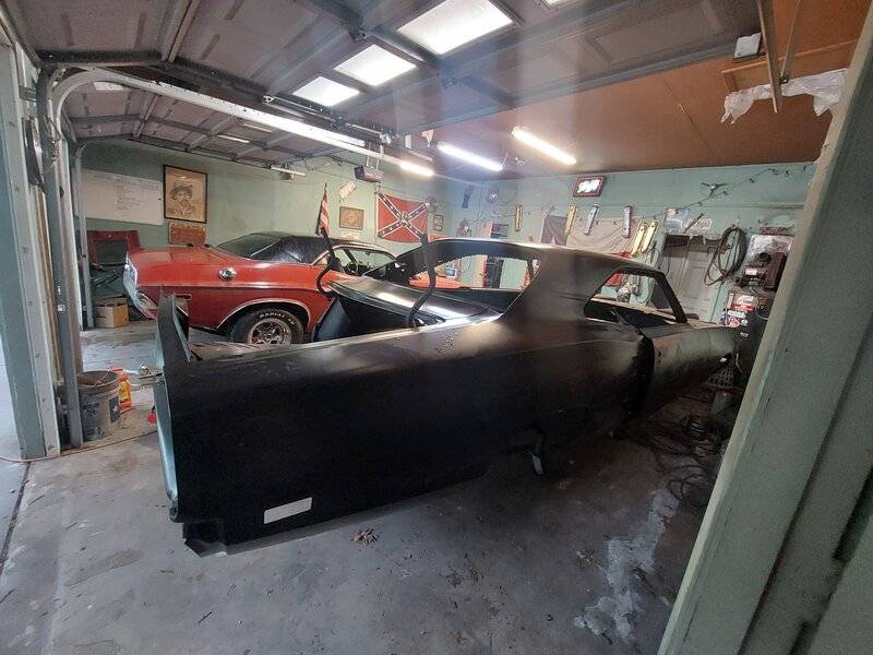

The only piece I need to get my super bee back together is a full driver's side quarter. Can't do any welding of the back end until I get it so I've been held up and I'm getting antsy. AMD originally estimated December 2021 arrival, then pushed to May, now I hear its still no set eta. I have a coronet parts car that has a semi-decent quarter on it (straight but will need several patches of its own). Is it feasible that I could get it off the car without mangling it beyond reusing? I want to get this show on the road already.

Your cars, your decisions, but man I'd hate to cut that other car up from that one photo. Is it completely rotted underneath and on the other side?
Ha I knew somebody would mention that. The picture makes it look like it's in good shape! Every panel has rust and the other side is hit hard. Frame, firewall, door jam area all tweaked. I took the trunk lid, fender, grill, interior pieces, trim, etc. So I'm afraid it's fate is sealed.
