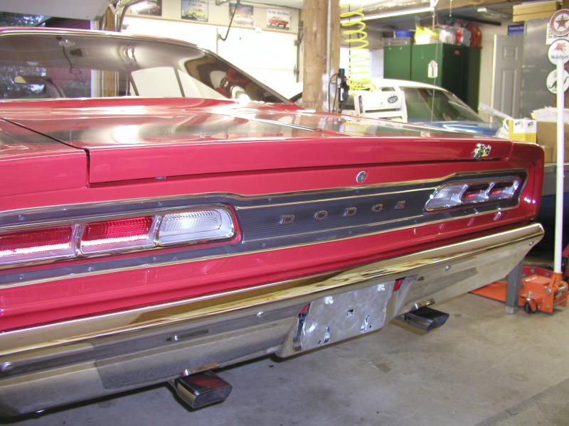

What color are the screw heads supposed to bee?
I cleaned up the finish panel and repainted it.
Screw heads stick out like a sore thumb.
Screw heads should be same as the tail panel.
Cardboard match and a little touch up paint... I will do it tonight.

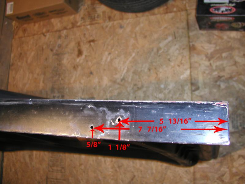

Any chance you would measure the holes in your trunk lid for the Bee? I used my Coronet trunk lid which has no holes.
I shouldv'e measured the Bee lid prior to selling the Coronet. I'm not sure how you could give measuring points but any help sure would be appreciated.
And thanks for your help.
Factory measurements shown below as best my old eyes can measure. This is an original unmolested deck lid from my Super Bee, not a clone, not somebodies hack job or wanna bee. Reason I know this is 'cause I've owned it forever.
Great job on the tail panel. Any tips on how you cleaned it up and what paint did you use?
I used 409, then dish soap. Hand dried. Believe it or not after 3 test sprays on a different panel with 3 different variations of black, Rustoleum FLAT black was dead on.
