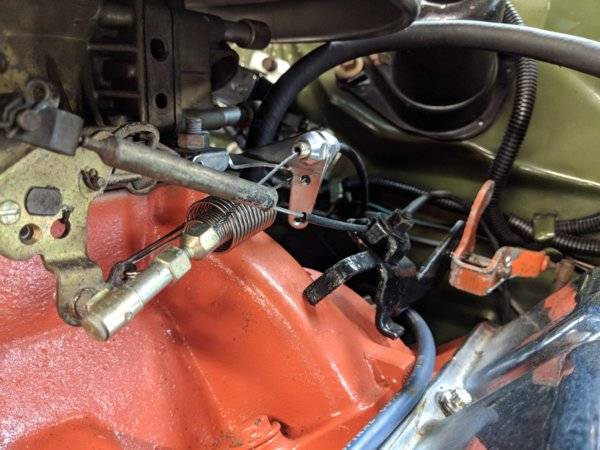

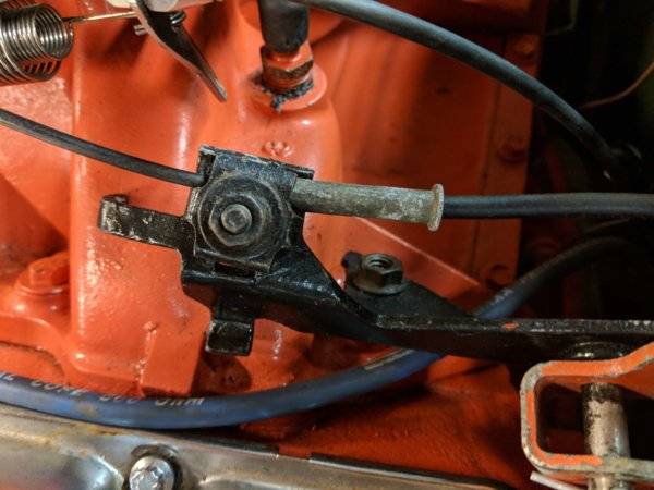

So this is on a 69 GTX, doesn't seem right to me?? What is the best way to strengthen this out? This car is a semi correct looking driver.
Cant thank you enough for all the help.

You may want to consider bouchillon performance throttle and kick down kit.
looks like a stock bracket on a tall RPM intake. there's an aftermarket bracket for what your doing. I think AR Engineering makes them.
Thanks guys, I ordered the AR bracket from Mancini it will look a little more original I think. I have the rocker piece but now where to get the rest of the linkage??? I had no idea anybody was making those brackets. Would the factory have painted that orange?

A&A transmissions, aandatrans.com, has reproduction kick down linkage if that’s what you’re looking for.
I have two bellcranks, some rods, and assorted items I can send you $50 shipped.
I'd rather talk you out of that mess and go with the bouchillon solution.
Sorry I am just getting back to this, old age, too cold, too many projects, too many excuses etc... I cant figure this site out, nor remember did I post pictures of the kick down cable that already exist? I would like the thing to look original, sort of, if I can... You like those cables that much?
If you have the original stuff, I think I would like to have it though. For $50.00 to make it look right and work? Someday?

You're going to need an extension on the rod that goes down from the bellcrank to the transmission. Edelbrock sells it and it'll be around $15.
PN# 8003 (1/4") or 8004 (5/16").
Worked perfectly on mine.
