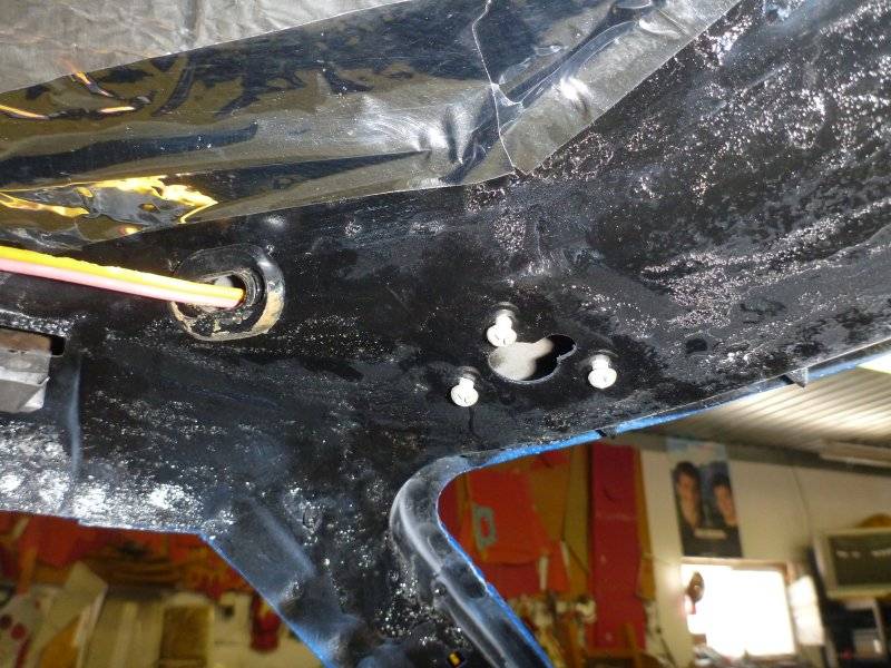

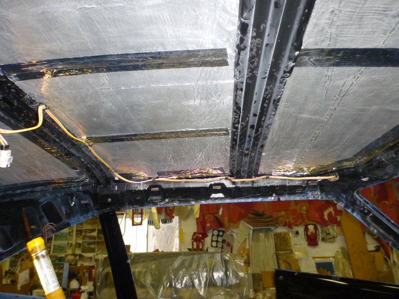

This part was off the car when I bought it. I know the wire runs along the left roof rail and then down the A pillar. Can someone show the specific clips and routing along the roof supports? I can't find anything in the manuals. Also, there are four holes on the transverse roof support where the light mounts to. Two on the facing the front side and two facing the rear. The housing only needs two holes and thinking it should be the rear facing holes. Any help is appreciated.
The plastic sleeve on the A pillar behind the kick panel for the dome light wire appears to held in by two Christmas tree plugs. Can someone confirm that?

Oh, excellent! I have the three clips along the roof side in a bag but didn't know exactly where they went. Looks there is a special grommet where the wire goes into the A pillar hole. I didn't think about that. I can probably find a standard grommet for that. It looks like you have the dome light socket separate from the base. Does it separate from the base?
I guess the only remaining question is in regards to which of the 4 holes the dome light base mounts to? Maybe doesn't make much difference.
Thank you and that is very helpful!
