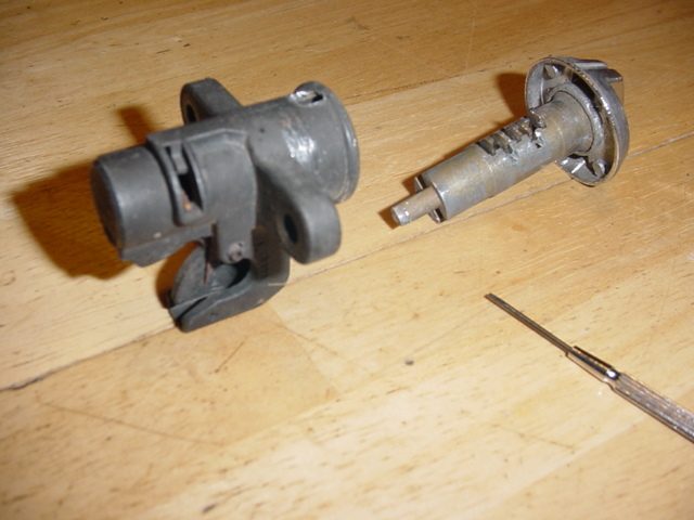

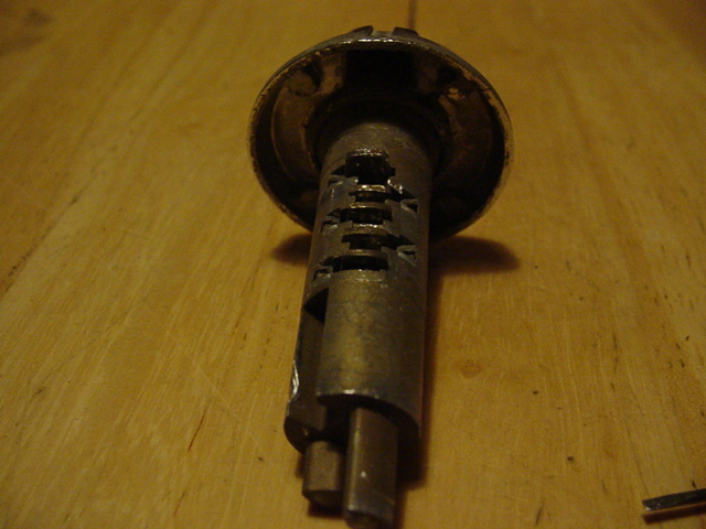

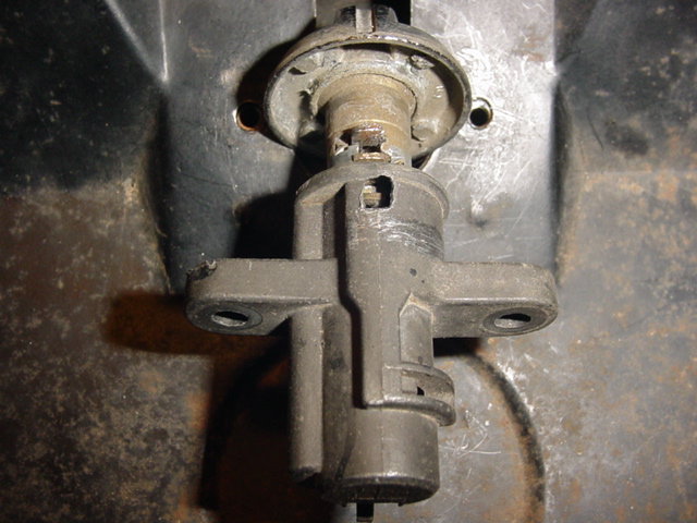

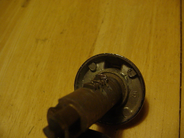

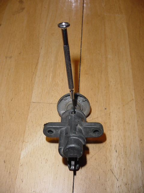

Don`t Pry !!!
Hope i`m not too late.
First, take out the two screws that hold the latch on the inside.
Second, place the catch in the upright postion to lock it.
Third spin the whole assembly 180 degrees.
Fourth make sure the chrome key receiver on the outside is parallel with the catch on the inside & now your tumblers will be lined up with a very small square access hole in the barrel part of the assembly.
fifth take a small screw driver as seen & with NO key in the outside slot, push the first tumble gently into the barrel & then apply a small amount of pressure outward. There are 5 tumblers that this must be done to and then your assembly will come apart without doing any damage. Take your time, & it doesn`t take alot of pressure to do this. Good Luck

I got it off but it did not have the pieces to push down to remove the lock cylinder in that little square hole although it did have the square hole. There is another square hole to the left of that hole and it had the pieces there to pull out the cylinder.

Don`t Pry !!!
