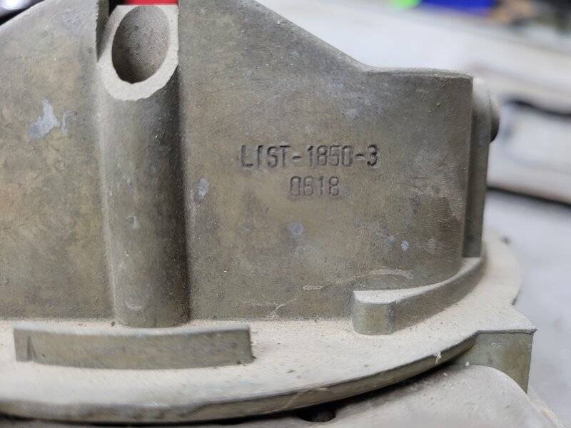

On the front of the choke airhorn is a "list-xxxx" and a three or four digit date code. Give us that, and we can tell you what you've got.

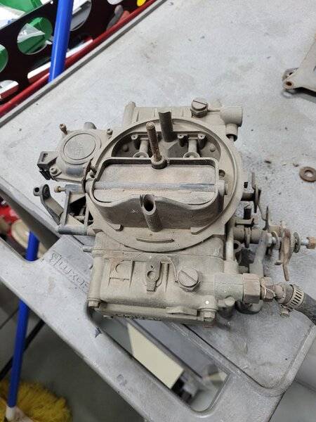

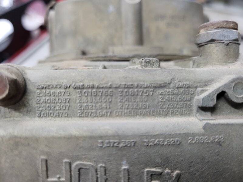

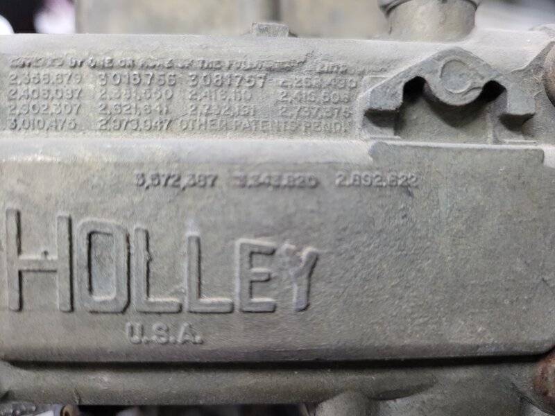

Please see attached pics and hopefully can help.
Thanks!
20211115_181505.jpg 20211115_181459.jpg 20211115_181449.jpg 20211115_181413.jpg 20211115_173358.jpg
That is an aftermarket carb, not factory.
I see you have a 383 automatic without N95 or H51
The carb you need is a 4368
Yep, sorry, the ultimate generic 600 cfm aftermarket carb. Yours is the third version (the -3) I think there are about twelve now. Could have probably bought that carb, along with a Big Mac at McDonald's.

The carb you have will probably work as well as the "right" carb. I would buy a carb kit, clean up what you have, and run it till you find the correct carb.
And good luck with your search.
Edit: a 600cfm is an almost perfect match for a stock or mild build 383.
