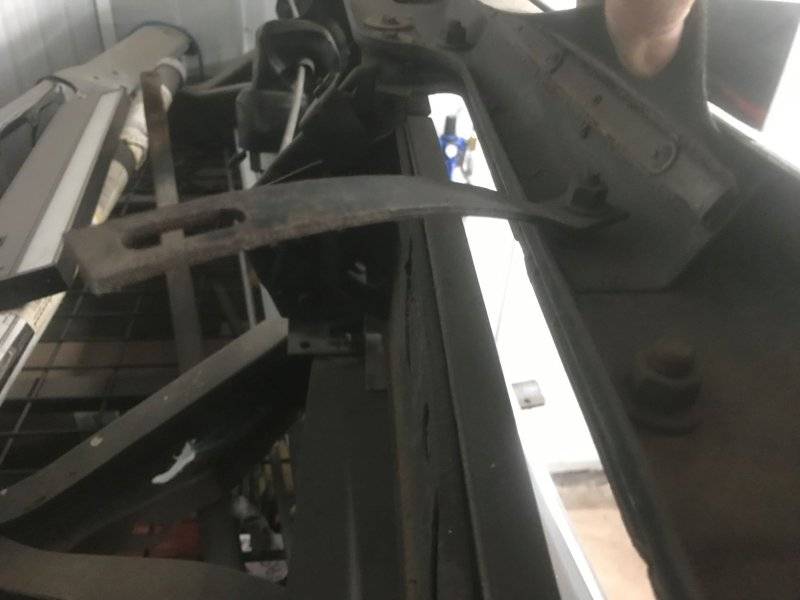

Here is the curved bracket that you need to unbolt (remove from fender, not grille).
Let me know if you need additional pictures - I have a few more saved on my phone including pics when I removed the grille from the bumper.

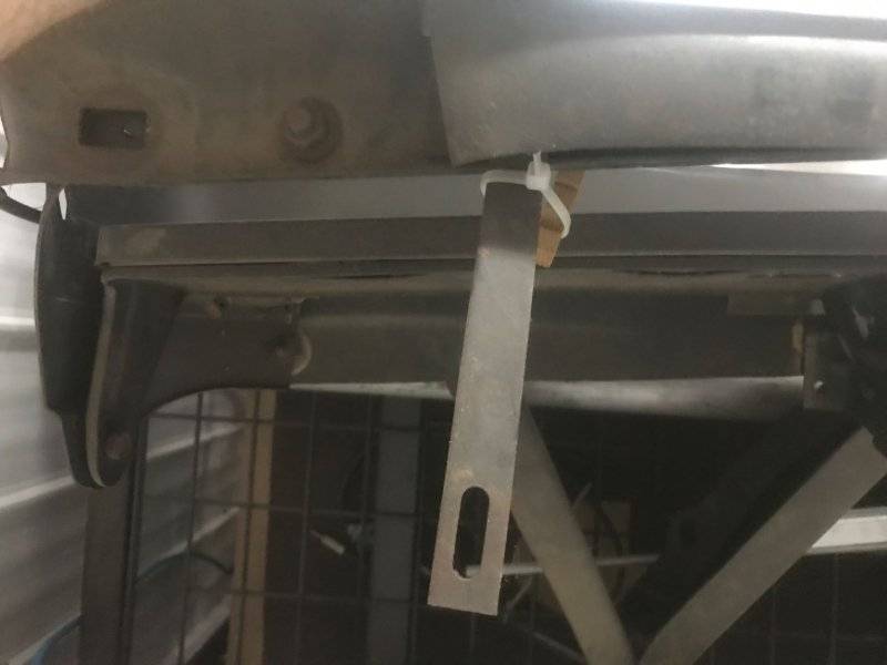

Here is different pic of that bracket. Yes, two bolts per bracket. One on the fender. One on the bumper. Don't mind the clothes pin and the zip tie. Using that to try to stop the droopy eye lid while on display off the car. lol

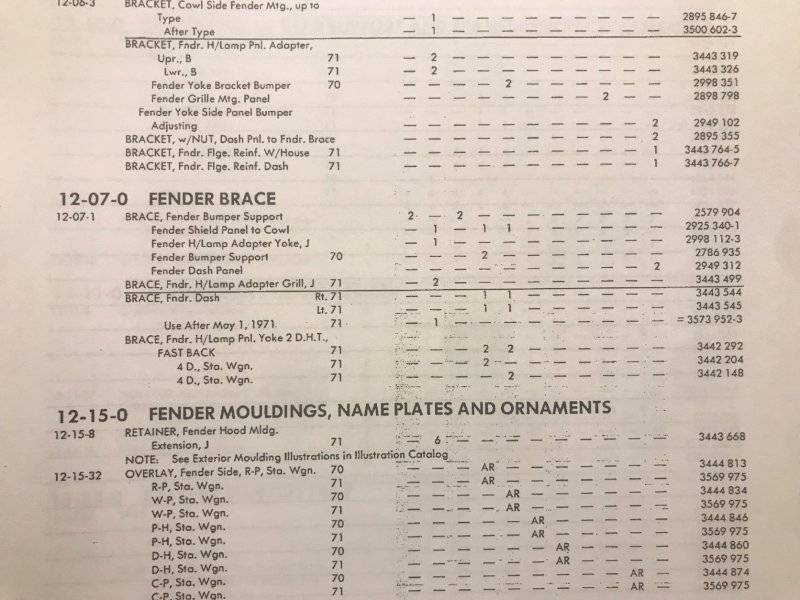

Just checked it out from my parts book. Called Fender Bumper Support. Part# 2786 935 In the picture it's 12-07-1 1970 calls for two of them. One for each side.

Same bracket, isn't it?? I see mine are bolted to the top side (23000 original miler) and ChargerST are bolted on the bottom. I wouldn't call then "J" brackets. Bent/angled yes.

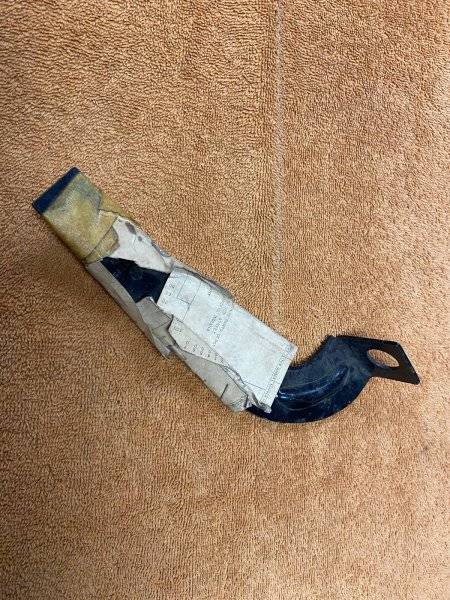

I am very familiar with these upper brackets. I am interested in the lower J bracket described above by chargervert. I am not familiar with any lower bracket other than the two main bumper supports that tie frame. Hoping we can see photos of the mysterious J brackets.

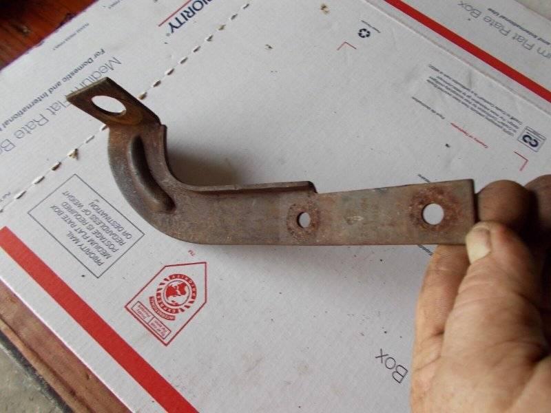

This is likely the bracket described by Chargervert. After looking at my parts book I do recall this part and I did include in my build. The one bolt he descirbes above is difficult to get at. It passes through the large hole in bottom of bracket. The other two small holes align with the rubber bumper pad at front of fender area.

Wow! My bad. Sorry guys. Yes the "J" bracket. I'm going to sit down now. Wake me when we get there. lol

And here is where it's bolted to on the pass side right behind the bumper.
Yes that is the bracket. If the front bumper has never been removed from the car they will still be in place. You will have removed all of the obvious mounting bolts and it still will be mounted solidly to the car until you look deeper and find them. Almost every 70 Charger I have seen that the bumper has been off these two bolts ae not put back in place.
