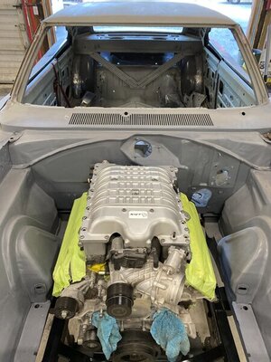

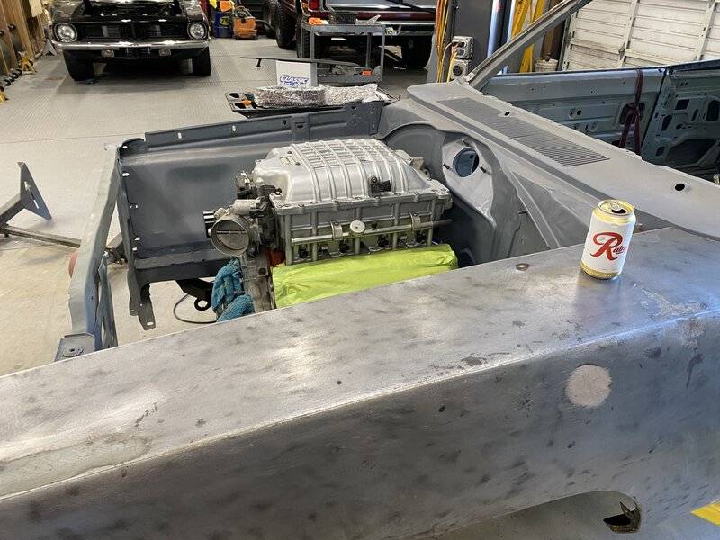

My 68 Charger with a RMS front suspension the Hellcat clears by 3/4 of an inch. I have seen others with stock K frame fit also. But I’m not sure about the he differences in the 70, if any. US Cartools sells trans cross members and tunnel covers. Mine are ordered and on the way.
37588C88-CC25-4AF9-B867-60B5AF192DEF.jpeg 5AFEF11C-8BE4-42D4-B862-F24D7CB438CE.jpeg

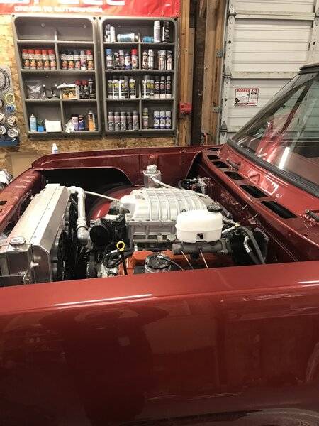

I am not using the stock Hellcat intercooler and radiator, we are fabricating our own to avoid the lower hanging. I will post pics in my build thread when done and hopefully some mock-up pics.
Take that back Ice box Performance is fabricating my intercooler and radiator. Here is a photo of the install of a fabrication intercooler and radiator in one with a Hellcat in a Dodge Trail Duster.
