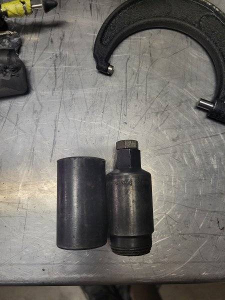

Buy this tool K-D 2392, or similar and it is a 2 hour max job. Make sure he changes the little seal between the levers, and the one in the case.
