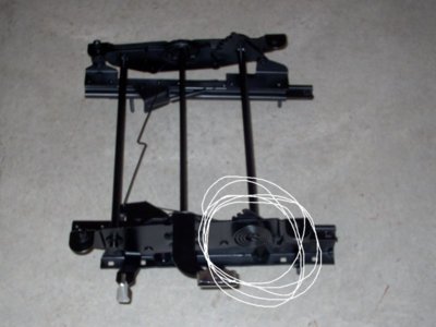

The spring goes into a slot in the shaft,I was going to tack the end of the shaft so the spring wouldn't fly off while I am trying to wind it enough to get it into the tab that keeps tension on the spring. It sits in about a quarter inch from the end of the shaft,so the spring shouldn't heat up when I tack the shaft. I will take a picture of it when I get home tonight.
THIS spring ...
The tab that the spring hooks onto appears to be on the opposite side of the shaft than the one in the picture that was posted. I used a very large Cresent wrench to put the spring back on. It took several attempts, and it was pretty risky. I used a heavy leather welding glove to hold the spring onto the shaft,while pulling on the spring with the wrench. Safety glasses were a must! Not a fun task!
'70 2-way are different than '69 - which mine is. The photo was just to show what you were dealing with.
That explains why the spring tab was in a different location than the one in the picture. Thanks for posting it,and for your help.
