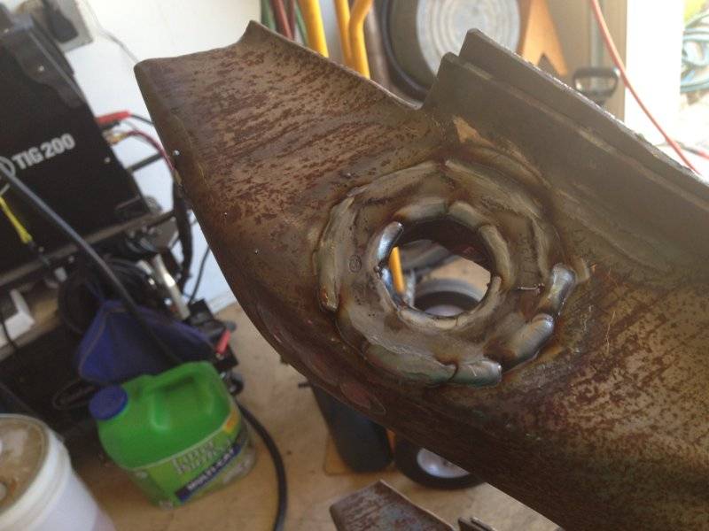

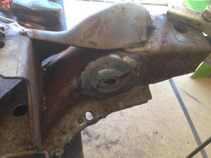

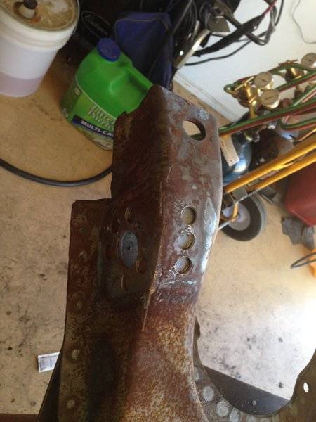

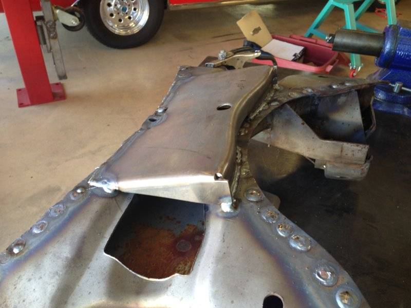

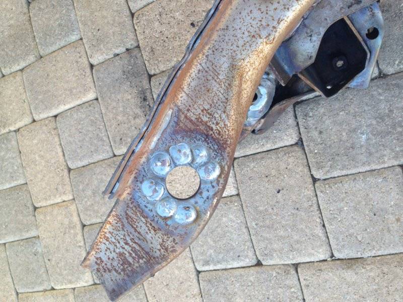

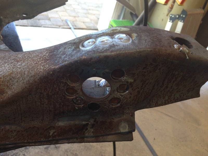

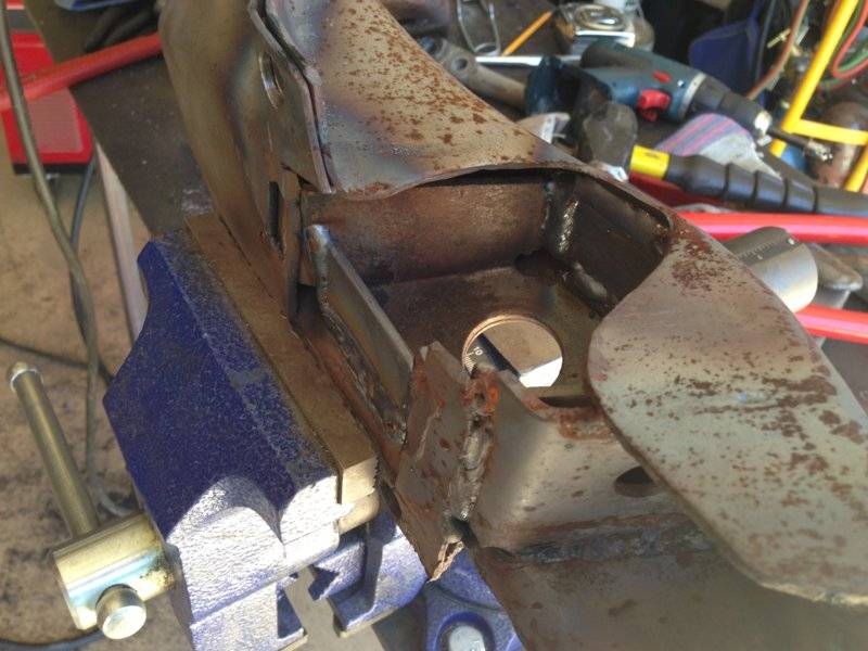

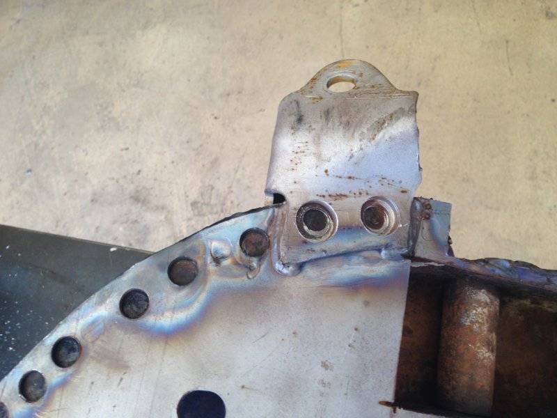

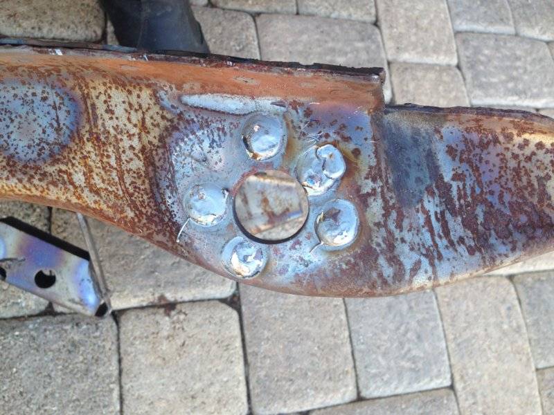

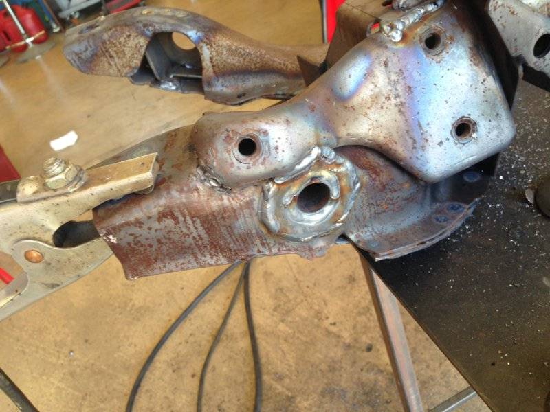

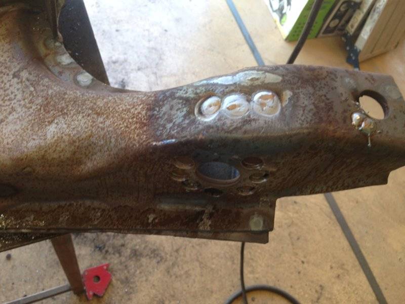

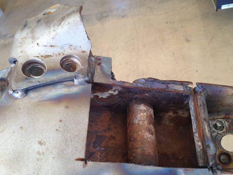

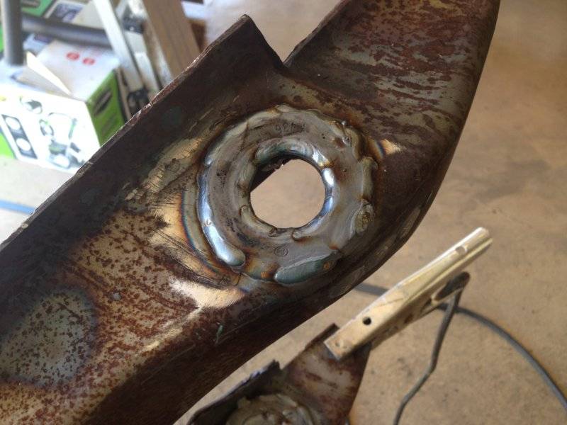

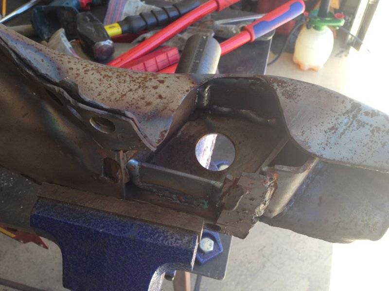

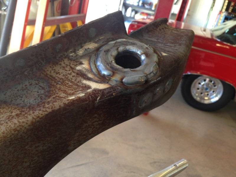

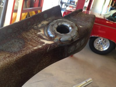

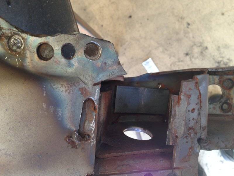

Since you have an extra k unit available, you can do some improvements on it by adding some reinforcements in various areas, add some extra welds. You can buy a reinforcement package from Firm Feel if you want to go that route or you can make your own. There are some basic areas to help out or if you feel like spending some time on it you can do like I did on mine. I added 120+ rosette welds around the perimeter, stock was around 30, punched through some of the multiple layer areas like the idler arm bracket, with stepped size holes then filled it up like a soft serve cone with the weld. The tube that the lower control arm shaft goes through can be beat up with age and needs to be looked at. The tube is only welded on the outside on the arm side of the k, the nut side is just floating. On mine I cut access windows on the road side of the k, welded the tube to the k on both ends as far as I could get the gun into that area. On the outside of it, arm side, I added a big flat washer that just fit over the exposed area of the tube, welded that all around on the outside plus the tube. You will need to heat them up some to form them to the k. The lower side area is flat but as it gets closer to the top it starts to go horizontal. On the nut side, I used the flat washers that were supplied with my Firm Feel shafts, welded them to the k after spotting them in with the stud passing through to line things up. After they were welded in, I put another big flat washer around that with it welded in and out too plus welded the cut out pieces back in. Where the strut rod goes through at the front, I added some pieces in the box that area in as there is minimal material there other than the formed piece on the outside plus minor stuff on the inside. I still need to work on the engine side of the k but that will happen in the future when I get back to work on it after my new garage gets built.
IMG_0891.JPG IMG_0892.JPG IMG_0893.JPG IMG_0894.JPG IMG_0895.JPG IMG_0905.JPG
Some work went in that k-frame for sure.
Although it does improve things, i think it is more "needed" on a 500ci stroker then on a 318ci.
More needed especially when I intend to autocross it. Even though I had that thing hot tanked twice, there was still a lot of crud in it. I ended up hitting the areas to be welded with a torch to burn stuff out. The car will get the usual structural upgrades plus I'll add to some of the areas to further tie in and reinforce for loads.
