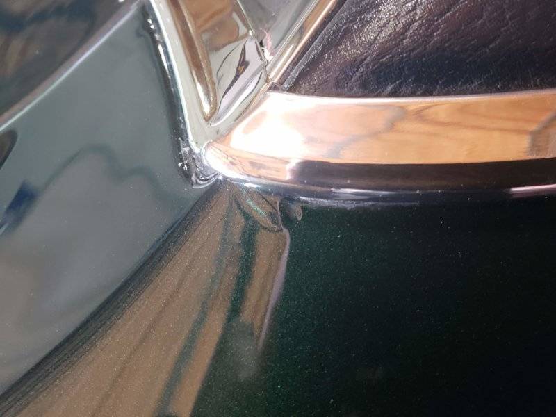

  • Fix small paint bubble near rear window trim. (It's not rust, maybe bad surface prep. Inject glue?)

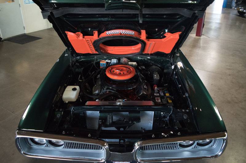

  • The Wizard radiator has a leak and will be trashed. Get a new one (another Wizard? An OEM Mopar repro that doesn't suck, if such a thing exists?)
  • Touchup some paint on the engine.
  • Replace some of the things in the engine bay that should be shiny but won't cleanup.

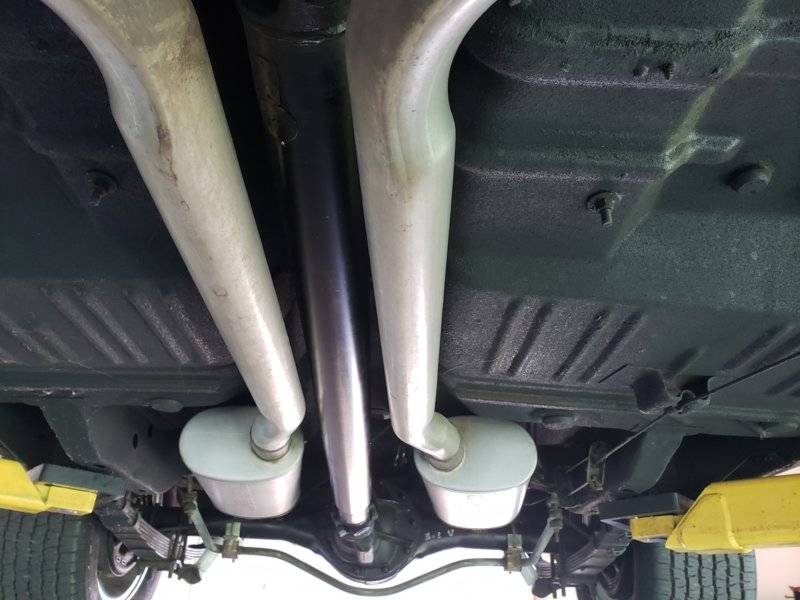

  • Replace the Magnaflow mufflers with my favorites, the Flowmaster Super-40s.
  • An exhaust pipe is pressing up against the floorboards and causing vibration. Fix that.

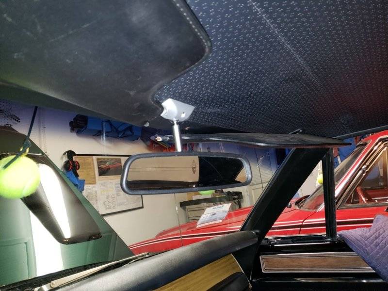

  • Replace busted rearview mirror.

I guess the first question to ask is that I'm super-OCD about paint, and the only non-trivial flaw is this small bubble near the rear trim:
It's almost certainly due to bad surface prep and not rust. I've read some people inject these bubbles with glue and press them down. Will that work here? I have a paint guy who can blend portions of panels but metallic is tough and that has to be a last resort. I don't want to leave it alone because I fear it could be ripped open during a detail, or possibly "grow".

Is it my eyes or is the bottom green-tinted rhino lining?

Radiator: GlenRay is correct and quality IMO

Not to rain too much on your parade, but that corner by the rear windscreen is a very rust prone area and is where they usually start.

I'd see if a local paint shop can photo match the color, and then see what's under that bubble.
I've had really good luck getting an exact match from out local shop, even with some hard to match colors.

The paint issue you have looks like the molding was not removed when they painted the car. Looks like material build up then tape removal. Or, the molding was installed too tight before the paint hardened and it moved the paint around. I don't see a rust issue.
I order to fix that you will need to remove the molding and pull back the vinyl top. Once it's all pulled back plan on sanding, priming, blending then clearing the entire quarter. Hopefully ending at the Dutchman panel seam. Chances are your blend line will look similar to the problem you have now if they build up too much material.

The repro GlenRay radiators look very sharp, but I chose to go the easiest path here and just order another Wizard. I don't know what, if any, mods might have been made to accommodate the Wizard that might interfere with install of a stock radiator.

Yikes. I think that will be Plan B. I just got some hobbyist syringes and some glue. Plan A is to make a small incision with an x-acto knife, insert syringe toward back of bubble, and deploy glue while slowly removing syringe and pressing out the bubble. If this somehow fails spectacularly I can always sand out the bubble and hit it with touchup while I await a better fix.
I was smoking crack. The bubble is not hollow but just paint over material buildup (good call 69L). It's really small and hard to see so I'll just leave it be. But I found out why my brakes are kinda spongy:

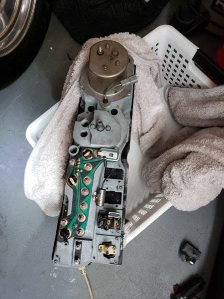

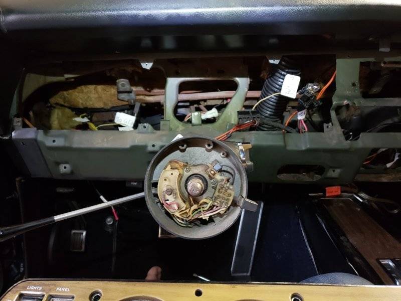

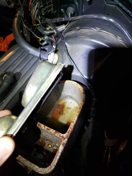

So the instrument cluster is in bad shape in numerous ways, and the general area behind there is a disaster. I can't patch things up just twiddling on it from behind on my back. I figure I'm going to pull it and have it over a couple months. I assume the car will drive without the cluster installed, caveman style... I know my GTO did. :)
Man this dash is a disaster. Literally the only thing the PO restored were the guts of the five gauges (even the clock works). Everything else needs to be cleaned, replaced, repainted, or dealt with in some manner. The heater box needs to come out too but that will wait until the dash is done (from what I read it can come out independently of the dash). I will be driving without an instrument cluster for a while it seems.
There is a lot of ancient crumbling insulation in the back. I assume I can just rip it out?
Also, my fuel sender seems bad, if I measure the ohms on the blue wire in the dash (which is the sender wire) to ground, I get 74 ohms. Tank is definitely full, so it should instead be close to 10 ohms. Luckily I have a new sender and that will be another thing the mechanic will replace.
Yay I replaced my first part! Goodbye old busted rearview mirror:
  • I've begun compiling a shopping list of parts and am getting quite a shock. On my GTO, literally EVERYTHING was reproduced, and was just a mouse click away on opgi.com. On this car, however, about half of what I want is not, and you have to get creative.
  • I think I'm going to bite the bullet and replace the dash wiring harness. YearOne has a near-identical repro for a decent price. I'm not sure yet if any of the non-working electrical stuff is due to old wiring, but replacing that old crap will rule that out for sure. It's also a "now or never" moment.
  • As for the heater box there is zero chance I'm going to rebuild that myself. Will send it out to one of those rebuild services in a couple months, I suppose.
