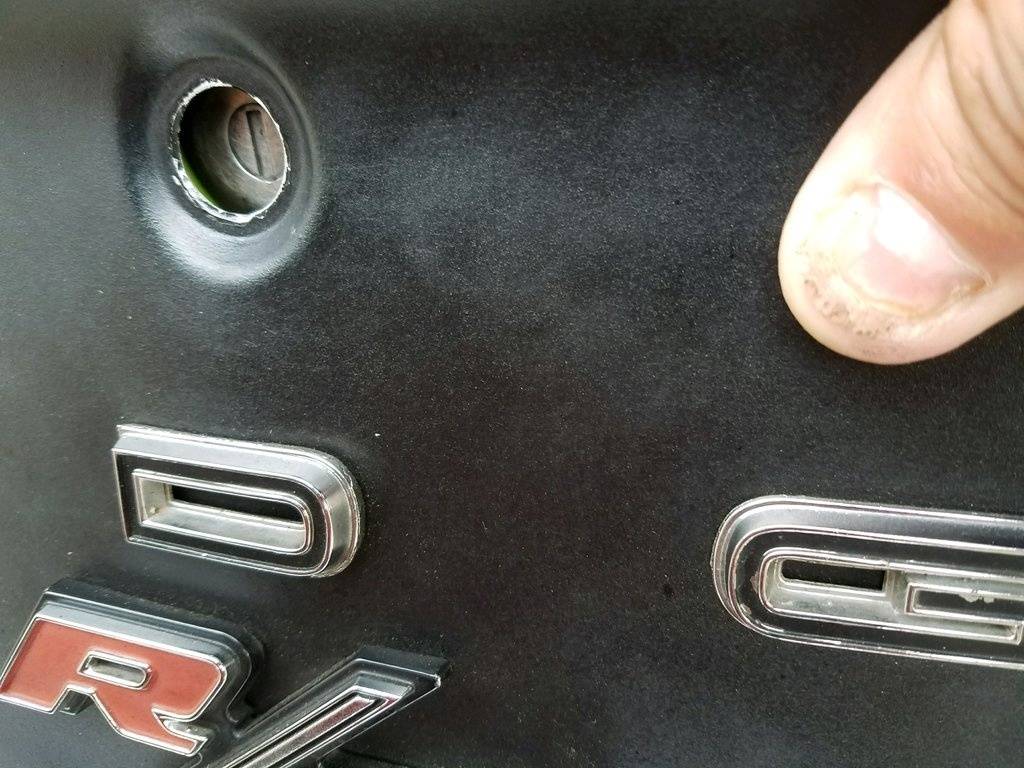

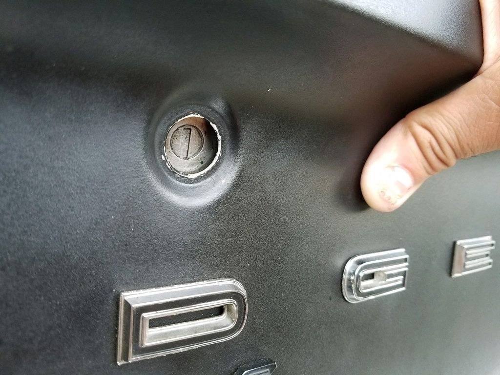

I have a '70 Coronet R/T. The trunk lock does not fit flush against the back side of the tail light panel; or actually the tail light trim panel does not fit flush against the body. So when I go to unlock the trunk, the key scrapes paint off of the tail light panel. I though about making a shim to shim the lock cylinder out closer to the panel, but then the retainer clip wouldn't have any grooves to slide into. I looked at a few cars at the recent Mopar Nationals, and only one out of three had the trim panel fitting flush against the body. I talked to the guy who restored the car years ago, he said it was like this when he got it and that i t didn't look like there was any collision damage. Has anyone else experienced this? Is it just the way the stuff fits?
Second question. I figured this would be a good time to replace the crappy R/T emblem on the tail panel. The existing emblem is glued on. The repop that I bought has studs on it and came with speed nuts. Are the studs and nuts correct? Do I need to drill holes on the body to make room? or does the tail light panel have enough of a gap between it and to body for clearance? Any help will be greatly appreciated.
That is 100% the way the factory did it. Look at my unrestored original, key rub marks. But the r/t emblem was hammed over on the back side originally. Like two studs that were flattened on the back side.

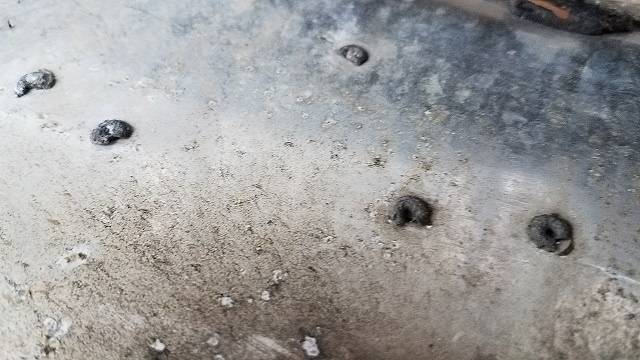

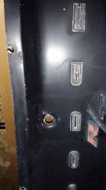

If the emblem is glued, that means its been replaced before. So are the DODGE letters glued too? The original cast had nibs that were hammered down, like a rivet (photo).
FWIW my lock gap looks like yours. True WS23V0_?
