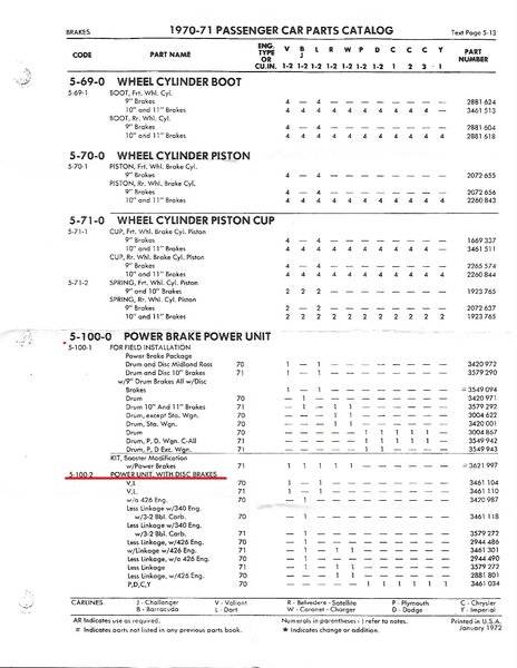

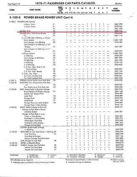

Was the 70 B Body disc brake boosters all the including the Superbirds? Except the Hemi.
Pages from the 70 parts book.
Thank You
Jeff
Yes, 67-70 B body bendix booster for disc brakes all the same including bird. Hemi was different in several way. Search will point out those hemi differences. 69 down, was bendix caliper, 70 was move to KH calipers but same booster. Master Cylinder is similar 68 through 70, but 70 had a different part number and internal piston change for the KH calipers.
