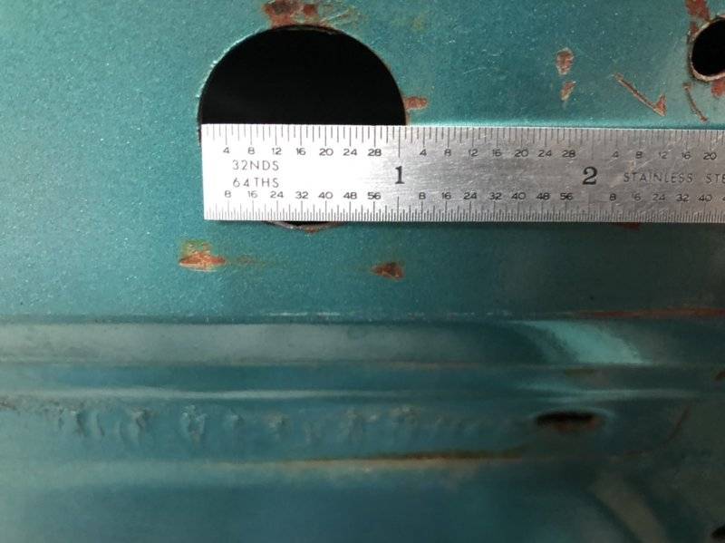

Hi hopefully i can add the picture. The hole is 13/4’s and a hair if you are old enough to know the saying. Perfectly round. If I can’t load the picture I can send it to you.
Thanks Ian.. I thought maybe it had flats to match the control body or a key tab... just a round hole eh....
...now what the hell is 13/4's? 1 3/4" ? seems big..
This is my 1970 Charger. I measured 1 1/32” diameter

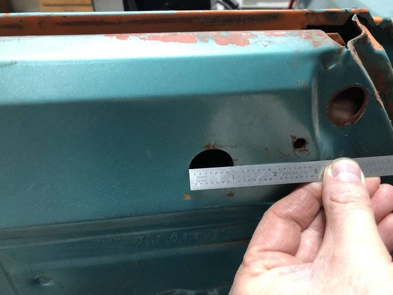

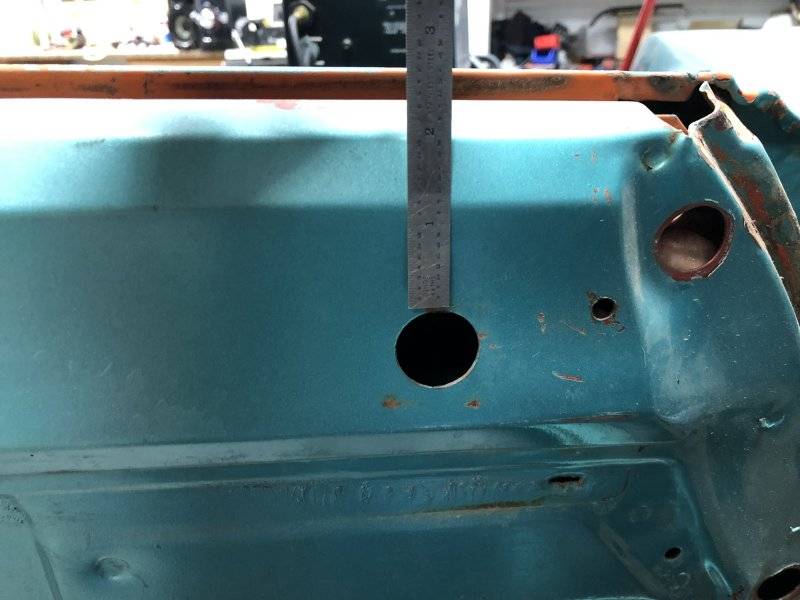

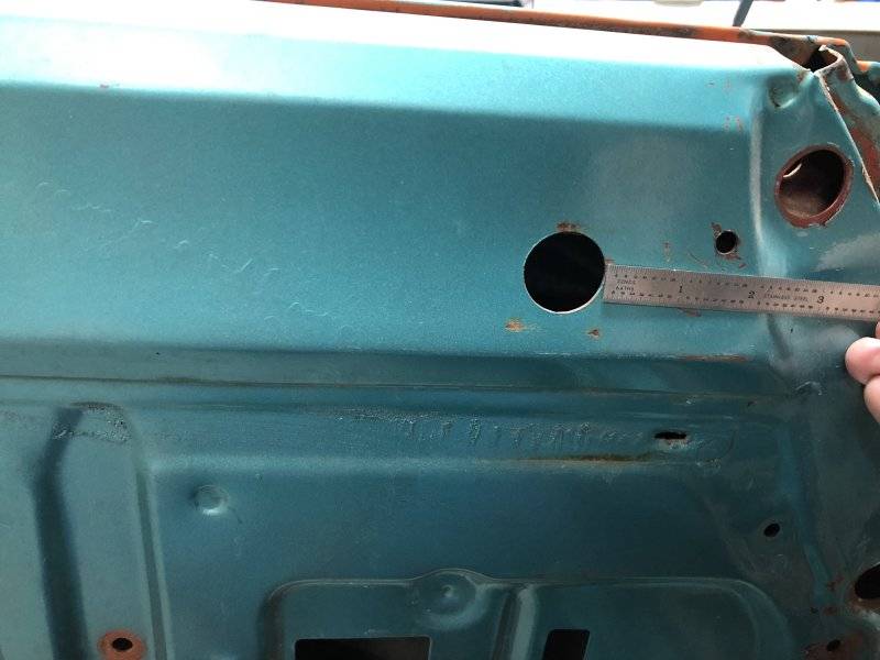

WELL!!! Found out that your doors don’t have full cards. I measured the hole in the door frame of ours which is covered by the panel/card. It is in inches. I would think that the 68 GTX shell I have would be like yours, never looked at it.
