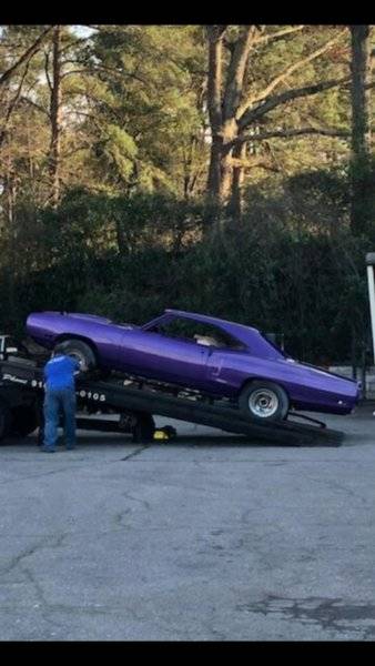

My youngest daughter loves the old cars like I do. In high school, she drove a '68 Camaro RS, and my '59 Chevy Apache before I restored it. I promised her a car when she graduates from college. It just so happened, that I acquired 2 1970 Dodge Coronets. Mine, is a purple Bee that will get transformed into a mix of new and old. Hers is an original 318 air car with bench seat and column sift automatic.

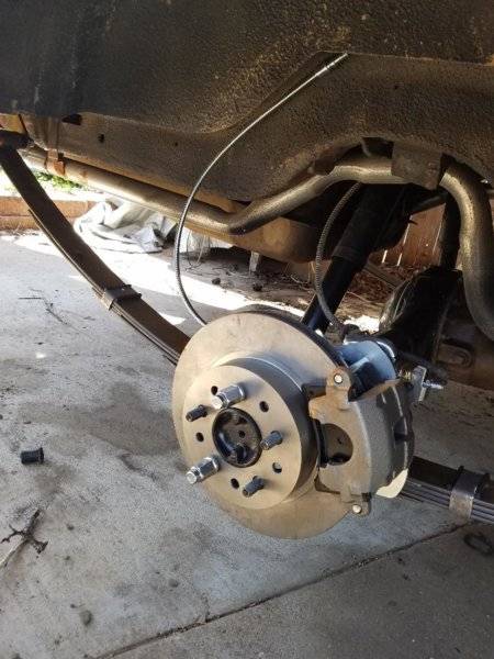

Now, I'm doing a 4 wheel disc brake conversion, new springs and a k frame swap , with all new bushings.

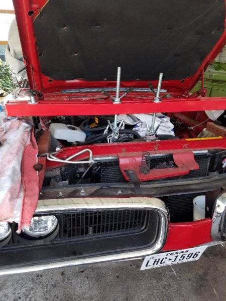

here are some pics
mine is the purple one

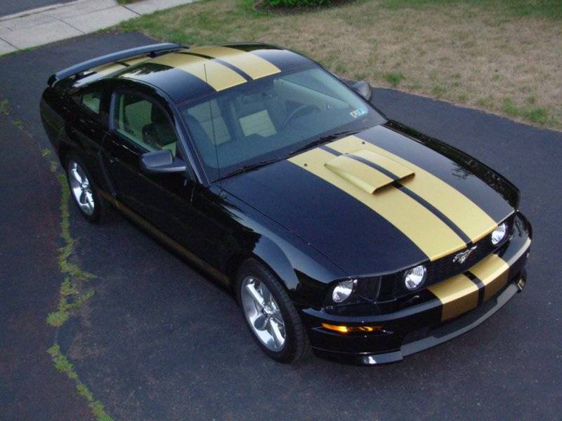

That's awesome. I gave my kids each a car for their 16th birthday. My son got my first car I ever owned, a restored 73 Road Runner with a 340. I loved that car, and now he does. My daughter got my 2007 California Special Mustang. I ended up driving a used, hand me down Buick Rendezvous, but I wouldn't have traded the situation for the world (plus, I then built my 70 Road Runner :))!
By the way, each of the kids got a contract with the car that they had to sign. They had the ability to buy the car for $1.00 when they turned 21, but if they broke ANY of the rules we established, even ONCE, the car was gone, and they knew it.
Me and my son in 1997
My son in the car when it was his
My daughter's Mustang

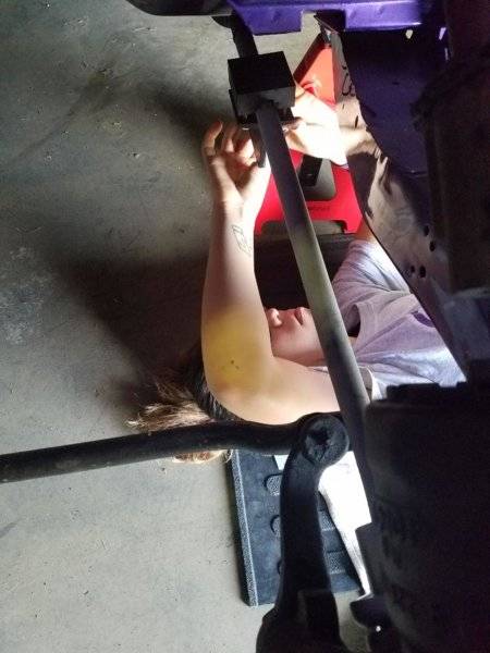

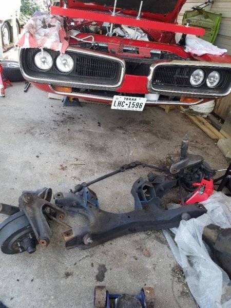

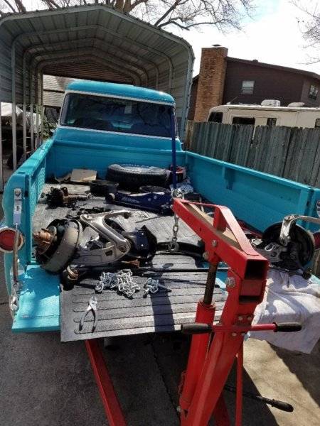

great post guys!! The daughter is home for spring break. She offered to help pull the k frame from my car.

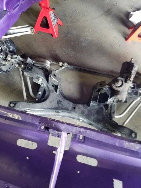

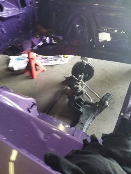

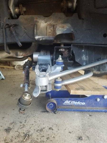

I installed the revamped K frame. I noticed that the previous owner welded on the lower control arm stiffening plates ! I'm going to finish out the disc brake conversion, then install the torsion bars.
It's getting there, slowly but surely

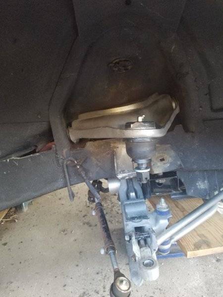

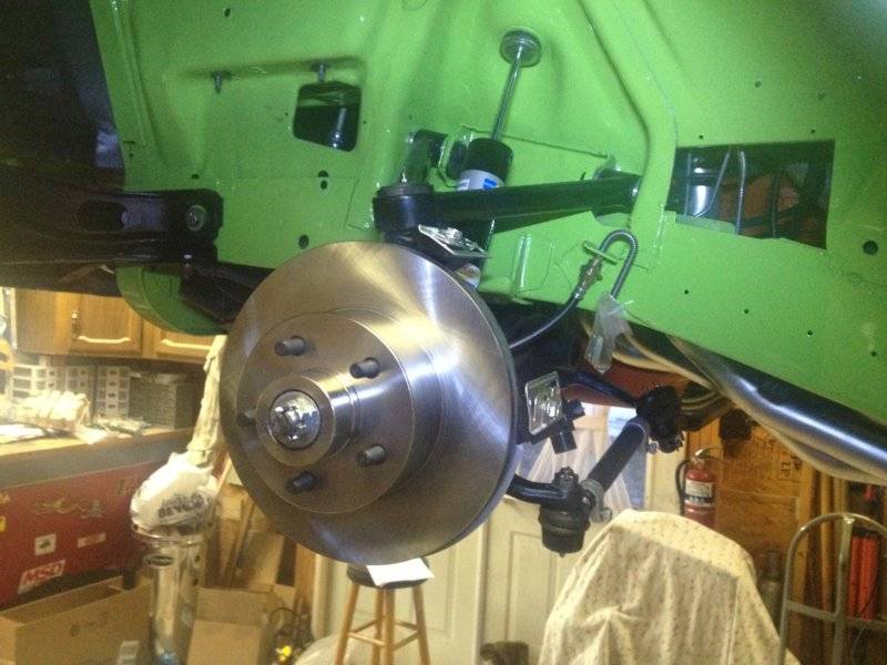

hey guys....I guess I'm a bit ignorant....

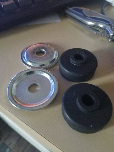

Bilstein front shocks come with 2 rubber bushings. Do I sandwich both on either side of the fender? Or do I just use 1?
Use both. One below the inner fender and one above. I have been very happy with my Bilstein shocks - they seem to work great.
Here are two shots from my car during construction in case it helps.
Cheers,
Hawk

well, I buttoned up the spindle and the control arms before I mounted the shocks. Is it possible to install the shocks without releasing the spindle or upper control arm?
I tend to ask questions before I have given things a good look for myself. Sorry about that.

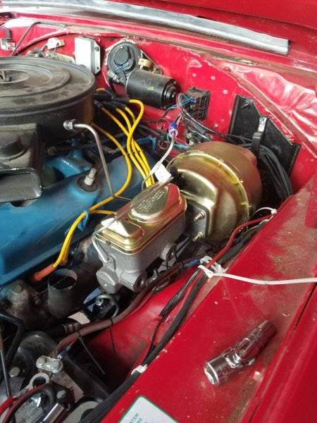

More progress...

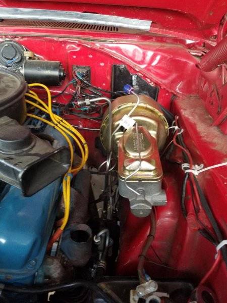

I'm not diggin the pre-bent lines that I bought for my disc brake conversion. I guess I need to add another loop or bend

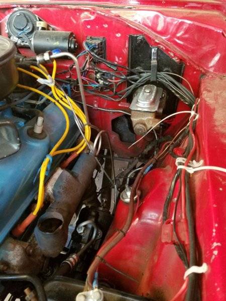

I really enjoyed you r build thread hsorman. I skimmed through it, but it looks like you did an amazing job. I looked for more pics of your firewall hole issue. I didn't see what the final solution was. It looks like you went with a different boost set up.
I now have discovered that I have the same hole in firewall problem. I bought the kit from the same comapny that you did.
I'm waiting until Monday to give them a call
