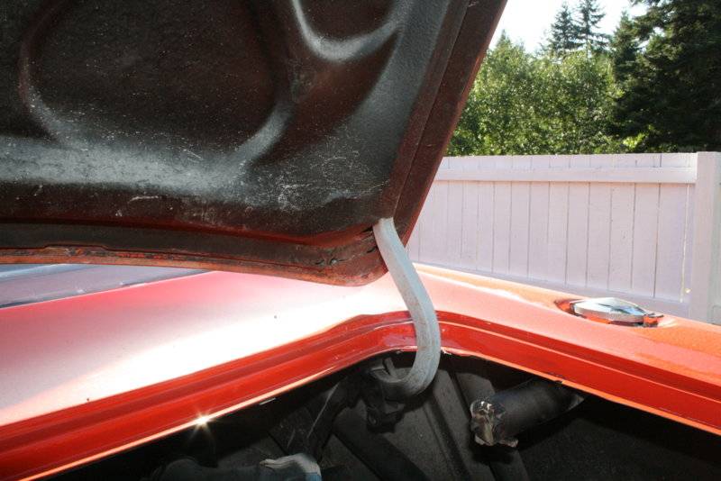

On the way back I pulled into a rest area and took stock of what was on my trailer. While it looked good from the outside, it was basically a painted shell. My "theory" is that the car was found in a field by someone who saw big $$. The car had/has some oddities about it, first of is the tilt front end which is actually pretty well done, then there is the roll cage which is not well done at all, finally there is the Charge like quarter panel fuel filler system which is partly well done (the quarter panel part is good but getting the filler to the tank is another story). In short, the car needed about everything other than paint, so when I told my buddy he immediately said "dump it". Well I had been looking for a 70 Satellite or RR to build a Superbird clone, so I said I would take it.

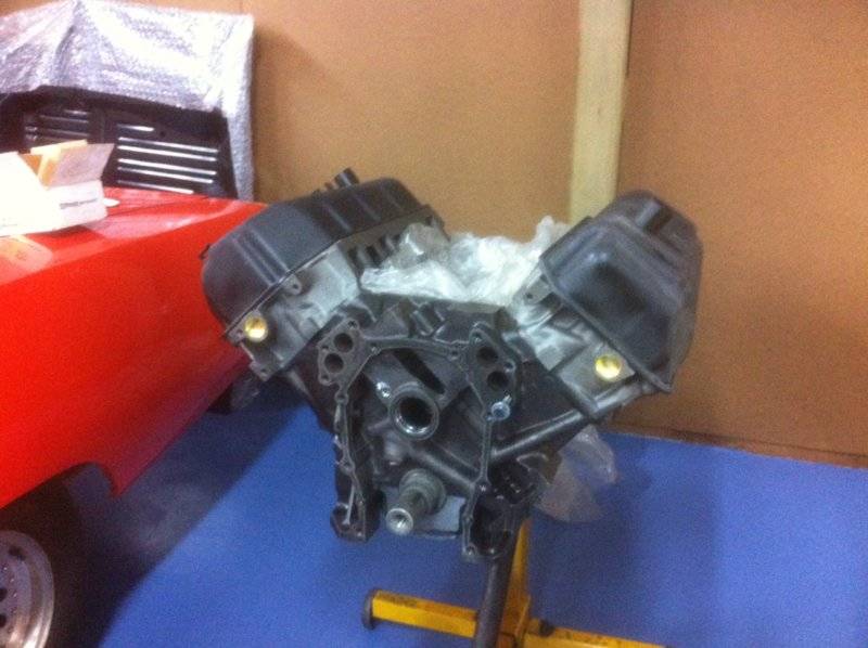

So, what are my plans for this.... Well originally it was pretty simple, drop in a 440 and 4spd and move on. For me, I need a long pistol grip and an air grabber and I am one happy camper. Well plans change and I came into a 1966 426 that had been a race motor that had been windowed but repaired and continued to be raced. I had it sonic checked and it is good. I had the short block redone and the heads so there is that.
Then I fell into a 69 B body Dana with 3.54's as well as a 833 (23 spline), so the die has been cast. I was recently thinking about selling off the 426 and buying a 5.7 or 6.1 but I go back and forth with it. If I keep the 426 it will have EFI on it and an exterior oil system (the rear main cap where the oil pickup tube goes is "iffy"). As it stands I am going to have to run some pretty thick head gaskets to get the CR down to something reasonable or swap out the pistons which I think are like 13.1 currently.

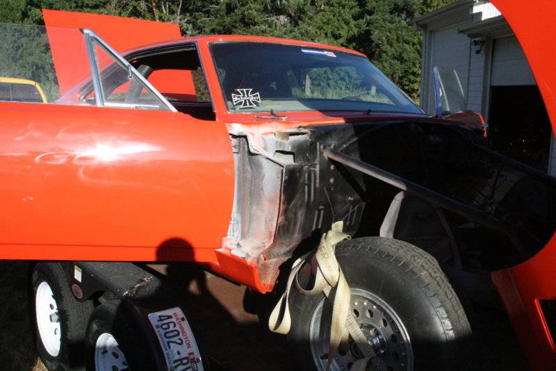

All of the window clips are gone and someone put some putty like substance in there I guess to make it look like a modern car with flush windows (even though they weren't flush). The car will need quite a lot of work but not as much as my Cuda so its all good. I will be keeping the tilt front end I think but need to modify it because as it is now, you have to open the hood (yes, the hood opens normally) and remove 2 bolts, then close the hood and tilt the front end. I want to make a cable system so it can be opened from inside the car. I also want to make the air grabber electrically operated vice vacuum.
I believe I will most likely keep the Mopar K frame and Torsion bar arrangement as well as leaf springs but we will see.
So I welcome your comments, suggestions, etc.
Looks like a great project i do like the tilt frontend they usually hack the fenders to death that looks pretty good good luck

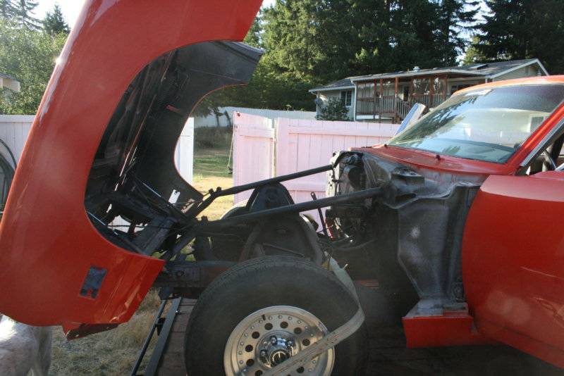

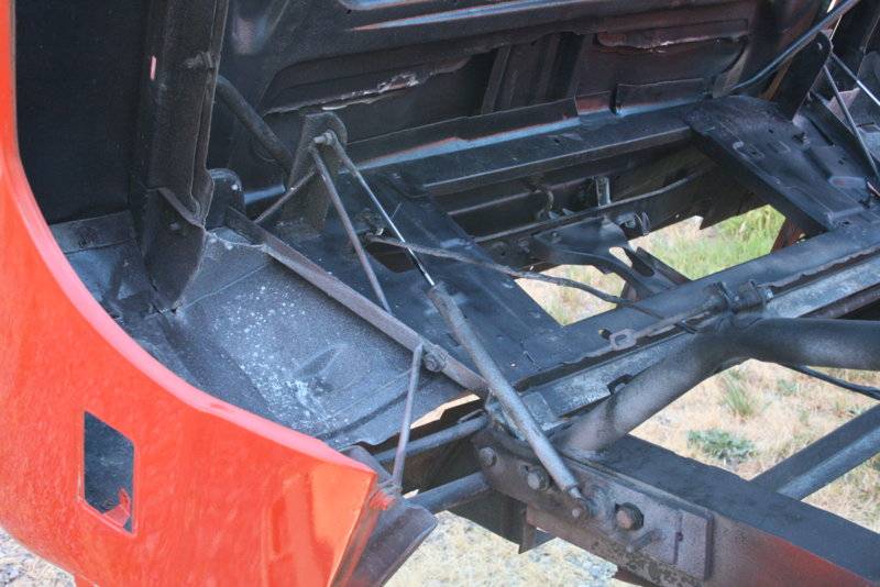

Thanks. Yes they did a pretty decent job on the tilt front end which is why I am going to keep it. The bottoms of the fenders (by the door) they sectioned and mounted so that when the fender comes down it sits on top of the lower part of what used to be the fender. They dud that because the lower rear of the fenders curve in and would not clear the fire wall. The only poorly done part was how it looked like they were going to try and mount the radiator; with rods. I suspect that whoever did the tilt front end was a professional or someone with a lot of experience. Whoever was then supposed to build the rest of the car not so much as you can see significant differences in skill. The radiator support tilts with the front end (as does the grille and bumper), therefore the radiator is going to have to be mounted to the front end support tubes (which will have to be replaced because one of them is split). Also, they just hacked up the shock mounting plates that used to be a part of the inner fender well, this will have to get rebuilt as well.
I will have to do quite a lot of re-engineering on the front end of the car to make it safe and drivable since a lot of the front end strength is now gone.
