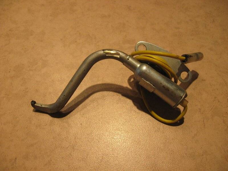

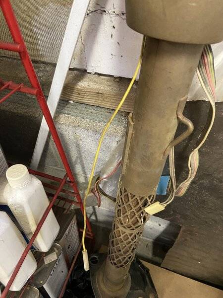

Can anyone tell me what this yellow wire is for and where it connects? I have several wiring diagrams and cannot find this little critter.

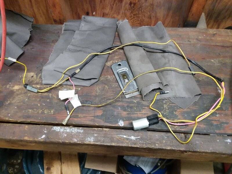

Thanks, now just need to find wire it connects with.
Find this cylindrical flasher hanging around down the dash and track the wires, and you'll find the plug
