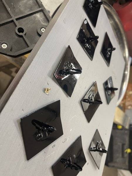

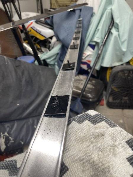

Ok I have verified my clip solution. It works very well! I will now set up to make 18 that I need. It’s a bit difficult without a sheer press but the width is crucial such that they can slide through and yet stay retained in the channel. The clips need to be cut down to get the right height and the steel plate slightly concave. But it works well it’s all steel and strong and can be removed successfully without braking like those plastic ones. Here are some pictures if anybody needs to make their own.

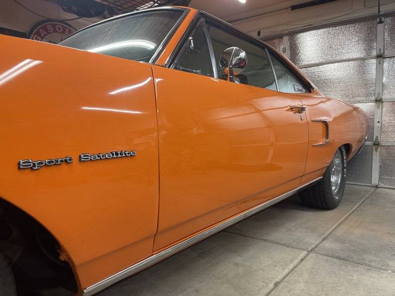

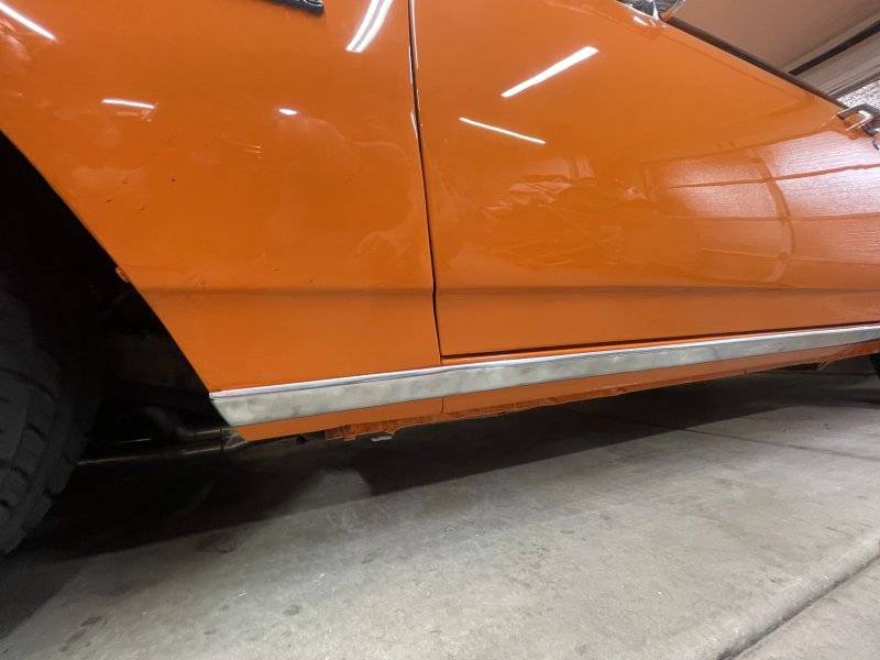

This worked really well! The moulding popped right into place securely!
good old Ingenuity. Sometimes with these old cars that is needed to fix your problems. I had a 70 Sport Satellite before the Bee. It took me 6 months to find a good used set of those clips in 2015. Good job!
