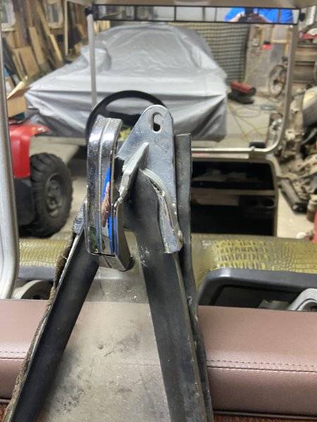

OK, I`ve done plenty of glass R&I but how do I get out the quarter glass on my `70 road runner? I`ve removed one screw in the rear corner and three screws along the front edge - am I missing something or is it just stuck? Also need a trick to hold the outside chrome pop out button from spinning to remove the mechanism without marring it.
You may have to remove the 1/4 panel.
Just kidding. I have one out at home. If no one chimes in I can take a look after work. I think it’s only 4 screws 3 in the front and one in the back. There is a strip of adhesive foam along the top.
