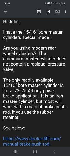

What master cylinder did you use make/model/year
I used the kit from Dr Diff. Used the 15/16 master cylinder for my yr, '67. But here is a reply from him on a stock replacement
