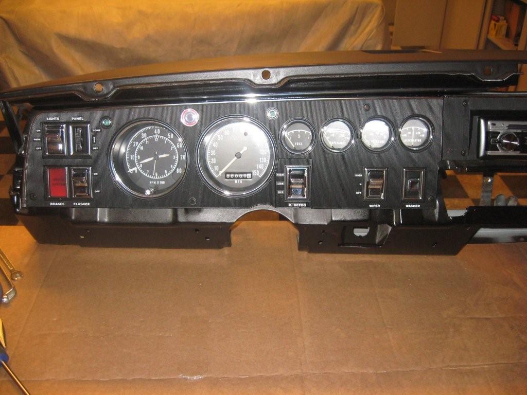

3/8" is the size, and there are SIX of them. If you pull your glove box liner and instrument cluster it makes it much easier to get to them.
you can see the mounting holes here with the pad off
