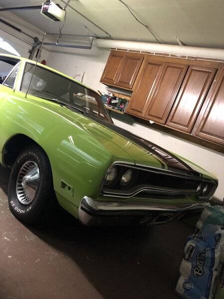

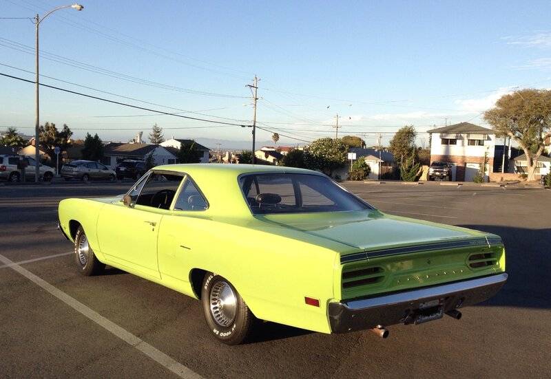

Hey everyone!
So with summer around the corner I was looking to get some advice of how to get my car road worthy again. Hope y'all are staying safe in these troubled times.
Sorry the photos I have aren't the best! But I have a 1970 Road Runner that is manual with pistol grip for a 383 small block.

Welcome from Alabama. Nice 70RR. We don't know how long it's been sitting and that would help on the advice. I see the front side marker missing, but that won't prevent you from driving it.

It has been sitting in the garage for about 7 years, the most love it received was seeing the driveway during family events. The side markers were the first thing I noticed, I tried to replace them and that's what brought me to FBBO. After I got the new ones in, they didn't work, so I took to the forums to find out most likely one of the ground wires are dead.
