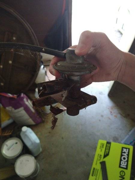

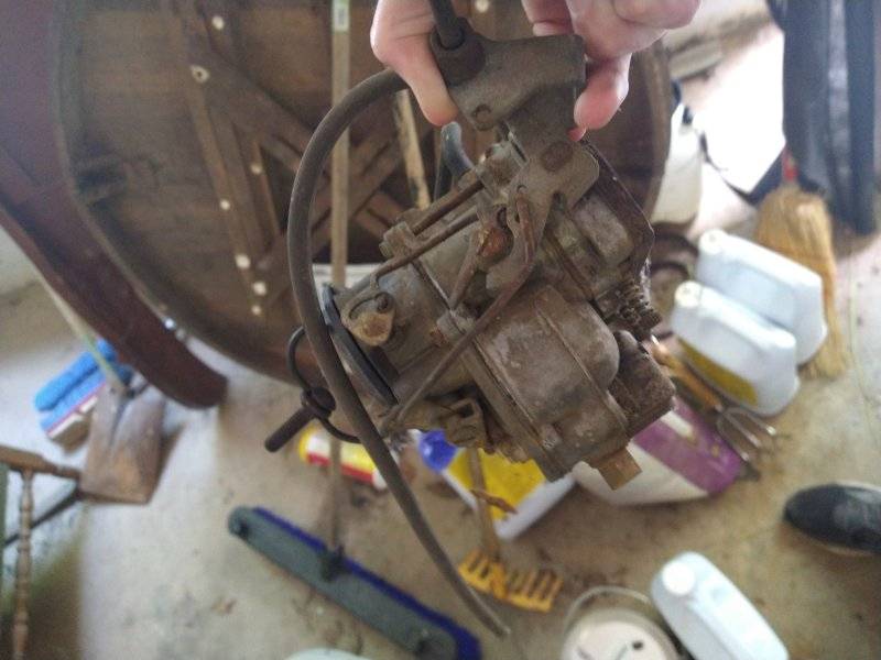

This is the state of the carb and that other piece that goes onto it ( I don't know what it is called). I'm guessing that I just need to get a new carb and a new intake manifold because both are very rusty and have been messed with by mice.
IMHO, it's best to work with what you have for now. You don't even know if this engine is any good yet... so I wouldn't start a shopping list just yet. That carb looks pretty fair to me....pop it open carefully to save the gaskets, clean it out, reassemble, and use it as your starting point to try and fire the engine. For all you know, the engine has a cracked block, melted piston, or who knows what else. You don't want to start buying parts for it just yet if you don't have to.

IMO....the second pix appears to be the EGR (Exhaust Gas Recirculation) valve, which is mounted on the linkage side of the carb and receives its opening vacuum from one of the carb's ported vacuum conbections. It must be in place b4 (but the vacuum line NOT connected) attempting to start the engine. The carb is a simple devices and and should be easily replaced with an auto parts store unit. BUT.....if you are considering a restored car, DO NOT let the carb go as a core....pay the core charge and condider having it restored by WOODRUF CARBS on this site....he offeres a discount....call him. ALSO, consider getting a FSM (Factory Service Manual) specific to your year, make and model of car.....its an invaluable source of information about everything about the car.....its available on line as a PDF.....can't remember the web site but someone will. Don't worry about the engines internal crud until you get it running....just make sure it has oil and coolant b4 starting. The '71 cars fo not have a complicated emission system. Since you have an EGR system, someone has changed intake manifold as the EGR system was not included until 1973 and later unless the car was origional built for California use as emissions were more stringent. Just talking out loud....

So I do not need the EGR system? The car was definitely not built for cali so I have no clue why it has that.
No. You can block it off.
That depends.....does your state or municipality require emission testing to get a license plate? Most classic cars USUALLY DO NOT REQUIRE TESTING....but some do. Check .....
EGR systems help to reduce the Oxides of Nitrogen (NOx) by reducing combustion chamber temperature to less than 1500° F, by introducing exhaust gas in the fuel charge flowing into the combustion chamber.....very effective at controlling NOx.....but it kills the performance of the engine....gags and stumbles when cold, poor MPG. Should you eliminate the function? Your choice.
The engine MAY have been replaced along the line by a previous owner with a later model, 1973 and newer due to a major problem with the origional engine. If your restoring back to origional, you may have to source an engine of the year of the car. If not, it doesn't really matter.....but the EGR valve must be in place to close the manifold and exhaust ports. Put a small BB or split shot sinker in the vacuum hose and connect the valve....result....it looks correct, but the valve won't operate.....just a thought......

That carb may seem crusty but its better than anything you're gonna find on the local parts shelf right now. It's a simple 2 barrel just rebuild it.
Once you get it running pour some seafoam down it's gullet.

Revisiting this, I absolutely do not care about anything beings number matching or restored to original. I'm confused, you say the egr valve must be in place to close the manifold and exhaust ports, but say I can stop it from working? I'm not that engine savvy so I can't really picture how it works. Is there a diagram I can find somewhere? I just want it to perform as good as possible and be reliable so I would definitely want to delete this if I can.
The origional EGR system control valve is mounted on the intake manifold on the linkage side of the carb on the exhaust crossover passage. The valve is controlled (opened) by a vacuum signal from the carb. Perhaps you should obtain a copy of the Factory Service Manual (FSM) for your year and model car....free online download....download the file which shows the emission control section for an understanding of how the ERG works. As I noted b4, simply remove the vacuum hose from the EGR valve and it will not open,
