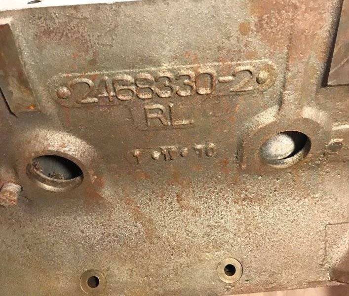

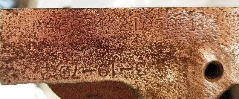

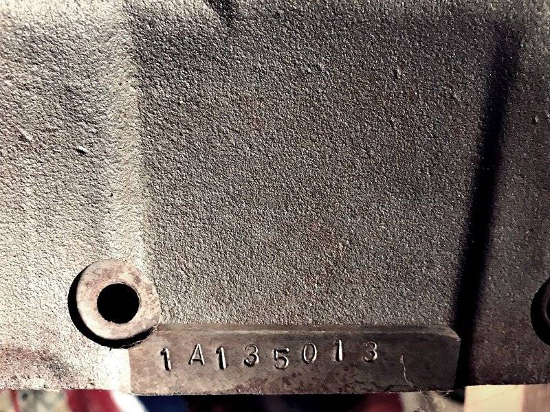

Can anyone help me decode my 71 hemi bare block that I own.
I was told by the past owner that the block came from a 71 B body car originally.
can anyone verify this?
can anyone here decode the numbers?
The numbers are hard to read because the block was sitting in a mans damp basement for 25 years and is pitted at the bottom.
The bore did cleaned up at .030
Thanks to all who participate in this discussion in advance!

When i owned a 71 Hemi GTX, 4 speed car for 28 years, my engine block also had that casting date.
The partial VIN indicates a 71 car.
so far so good..... that verifies what I was told.
Any other information that can be extracted from the numbers?
In fact a 71 Charger R/T.... Or perhaps a Super Bee... No Plymouths made at Lynch Rd in 71..
Obviously the 1 is 71, not so obvious the A is Lynch Rd... Now if WS23R1A135013 still exists.... Or possibly WM23R1A135013.....
W = Coronet/Charger
S = R/T M= Super Bee
23 = 2 dr hardtop
R = 426 Hemi
1 = 1971
A = Lynch Rd
135013 = sequence number
That is what I am looking for!!........i really appreciate your help Sir...
