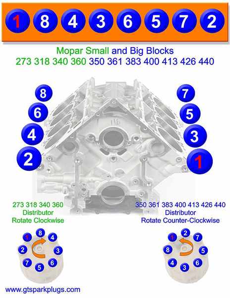

1,8,4,3,6,5,7,2 Counter rotation on the distributor. Number 1 front driver side.

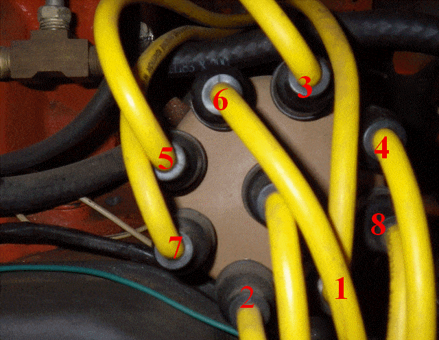

The aftermarkets may not be indexed the same as stock. Keeping the firing order the same you might need to index the plug wires around the cap. Find out where cylinder #1 TDC fires and index the wires accordingly. (ex.... maybe cylinder #1 TDC compression stroke fires at #3 on the cap, so that would be where you locate #1 wire)

I have never had the rotor point to #1 cylinder. I have had it point to #7, #6, and #2 (really at the alternator). I have reinstalled the wires in firing order for all of these scenarios. Do they mean #1 on the distributor ?

On the cap like the picture. Is your distributor a stocker?

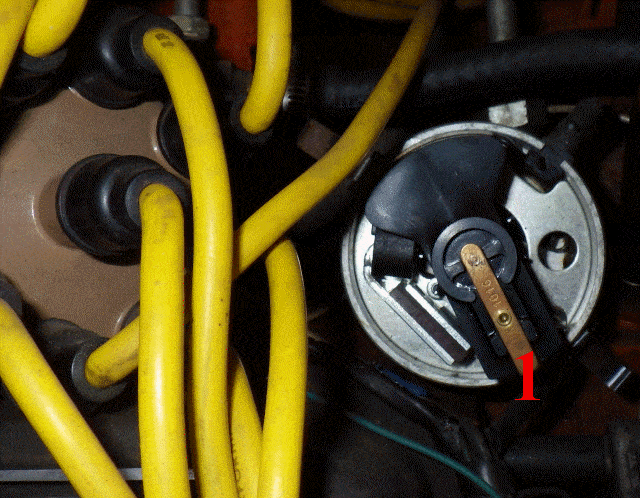

Herse's mine (an MP distributor)……………
"drop the distributor in, usually with the rotor pointing towards #1 cylinder"
For a stock distributor it was common to point the vacuum advance toward #1 CYLINDER on reinstall.
Yes, point the rotor towards the number one on the cap. It will be pointing between the valve cover and the alternator ish. The rotor does not point to number one cylinder on the drive side.
Ok, that makes more sense, just the way it was written confused me.

Its funny about #1 on the distributor...all the diagrams I saw showed #1 pointing towards #8 cylinder. Same direction of rotation, same firing order, but at about the 10 oclock position when veiwed from the right fender.
