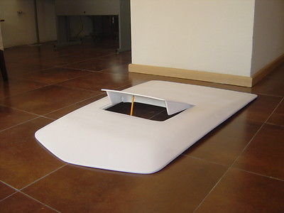

ive got a 72 satellite drag car. I want to put this repro air grabber bubble on the hood and make it functional cheaply. My plan is to just make a bracket or something to hold the air grabber door open all the time. Anyone done this or know of other grabber bubbles and doors? This one is the Mexico one from el paso

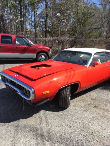

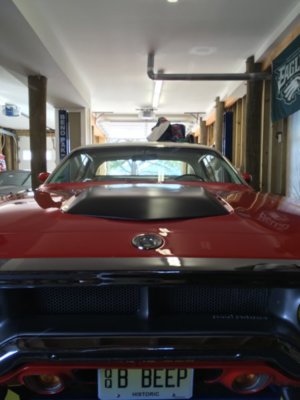

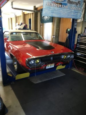

I just built a complete functioning AG and it Is a tall task. I used a stinger bubble and there is a lot of hours in prep. I would never do it again !
A lot of fiberglass prep? I'm just looking to bolt it to the hood and keep the air grabber door open. .basically a cool looking hood scoop. Did you have issue with the fitment of the bubble too?
No fitment issues installing it to the hood just work cutting and drilling the hood. My body guy had issues with pin holes that kept showing up. I did the work putting the studs in and it was a pita, I was also told that the bosses were solid and most of them ended up being hollow. I had to fill with resin then drill them out for the studs then I threaded the studs in but put more resin in the hole before installing the stud. This project was very time consuming and I didn't do any of the painting or body work.
Where did you get the mounting hardware? Looks like there are two types of studs used, about 5 larger ones along the back of the hump. I have the hood so the bosses to hold the bubble down will match up with the factory hood ok or are they misaligned?
The studs I used were all long. I got them off of eBay if I remember correctly. I purchase a satellite hood and drilled the holes to make it an AG hood.
