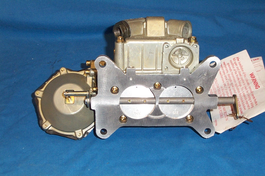

Just a thought, but couldnt one use, three two barrel carb spacers and achieve the same result.
That what these were. 3 seperate spacers. Not sure if 6-packs have the same base as others, looks like maybe so.
