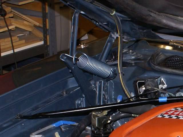

Looks like maybe clearance for the hinge.
