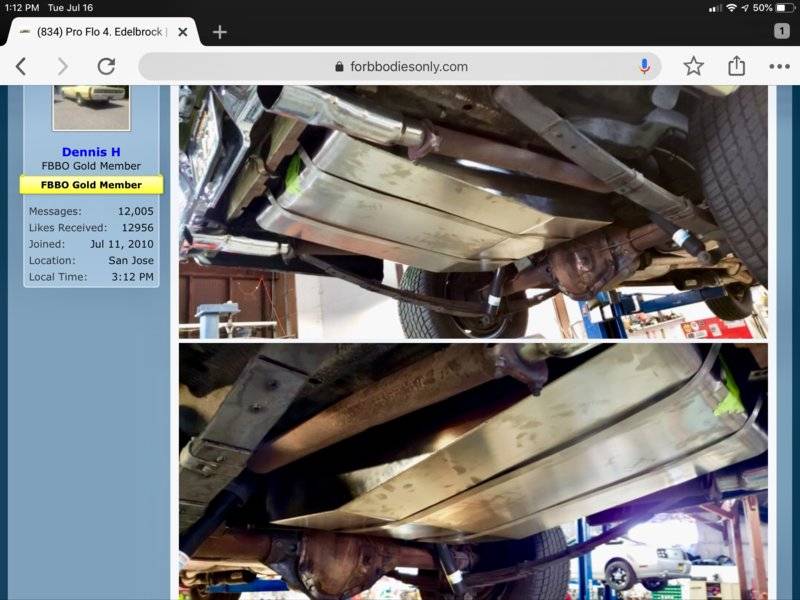

Ricks. Tank just installed.

Lost the receipt iPad dumped my “Notes. Pretty sure it was about 1600. Remember, it was custom with increased capacity and the best PMW pump available. It was about the same cost as the Pro Flo 4 itself. 1000 miles now. Perfect. Quiet. Extended range on the road really helps.

View attachment 801464 Ricks. Tank just installed.

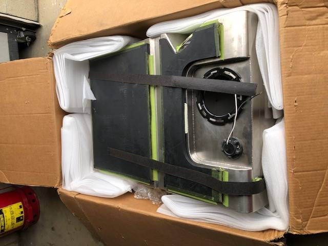

Dennis, so you would recommend the Ricks Tanks? about to jump on a good deal for an in tank pump stainless tank, but i'm going to use it for a mechanical fuel pump (until i'm ready to switch it over for the in pump fuel pump, pending some type of pump hat that i can plumb for the regular fuel pick up or use one of their in tank pump hat minus the fuel pump)
Holley makes some of these pumps, https://www.holley.com/products/fue...ters/fuel_pumps/in-tank_retrofit_fuel_module/
You just have to modify the tank.
thanks, received some info from Dennis. Also read up on venting issues with these tanks and then having to buy additional products to fix them. might just end up going with a stock tank and then when i'm ready to pull the trigger for EFI, i'll get me a retrofit pump kit. too bad, that Ricks tank would have been so pretty.
