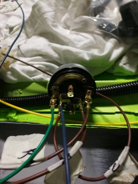

Anyone know if they repro the wiper switch connector behind the dash? Need it.
See picture of missing piece.

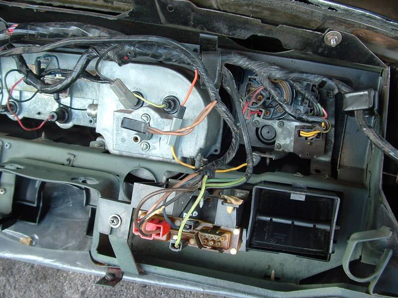

71 uses TWO conectors. One of them is the same L shaped one like flashers
I have the connector for the flasher. But I think the switch connector has more pins than the flasher connector.
No, I meant... the wiper switch for 71 uses two piece conectors, not one piece like 72 and laters. One of them is just like the flashers one.
Hmm oh I didn't know that. Good to know thanks.

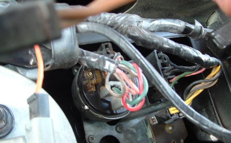

this is 71 E body, but prongs setup on these is the same... hard to see but if you look closelly, will find both plugs for the switch
Oh yes I see what you mean
An L shape and the secondary connector.
