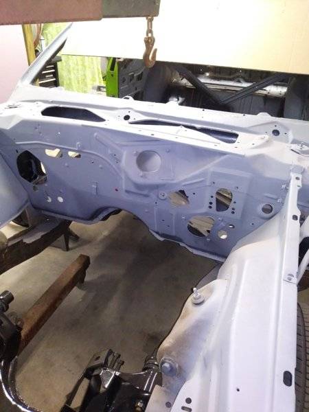

I personally have done it and will explain how my expierience went...
My car is a 71 Plymouth Satellite w/AC.
The firewall is a Goodmark 71-4 E-body AC firewall which I had to slice into about a foot on each side to get the windshield channel back into where it needed to be. This slice was about 5 inches below the windshield channel & I had to weld in a few strips to close it up.
The upper cowl was a total mod...
I used a new Goodmark E-body cowl to replace most of the entire front section of my original, as well as about 7 or 8 pieces along the windshield channel. It was a lot of work but here are the results...

I wanted to point out that the firewall, though everything you see is identicle, the top where it rolls up along the sides is shorter on the E-body, because the windshield is slightly forward than the B-body... It is slightly different in the curve as well. Nothing patience and ambition cant overcome, but to say "an E-body firewall will work without mods(AC or non-AC)" would be FALSE.
