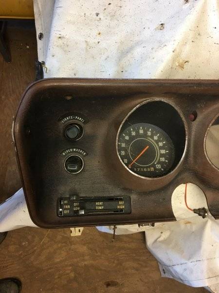

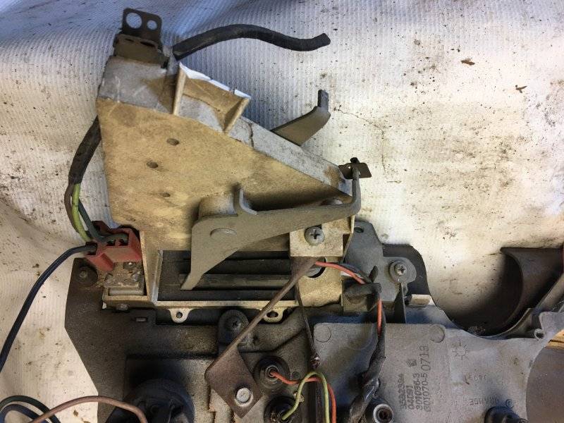

This is what makes me think the heater fan switch is vertical. This cluster came out of a 71 Charger SE. Maybe it was a replacement from a 73/4? But I've had the car since 2000 (parts car). The V.I.N. # is very low (100022) so maybe there was an early design change? From the back the installation looks "factory." Another interesting feature is the car has the drivers side directional vent in the dash (like an A/C car) but also has the outside air vent on the drivers side, the outside air connection for the heater box, and the outside air vent cables. I did not think non A/C cars had the driver's die vent in the dash. While the car did come out of a boneyard, I see no evidence the dash has been swapped out, and V.I.N. s match.

Looks like a 1973 Cluster with the 120 mph speedometer and the vertical blower heater switch
73 and 74 has vertical blower switch
I posted correct horizontal blower switch
1971 1972 in earlier post

I would have to see your dash inserts or vents for very rare Strato Vent option on 1971 B Bodies only
Strato Vent would bee written in lettering on the heater switch face plate
