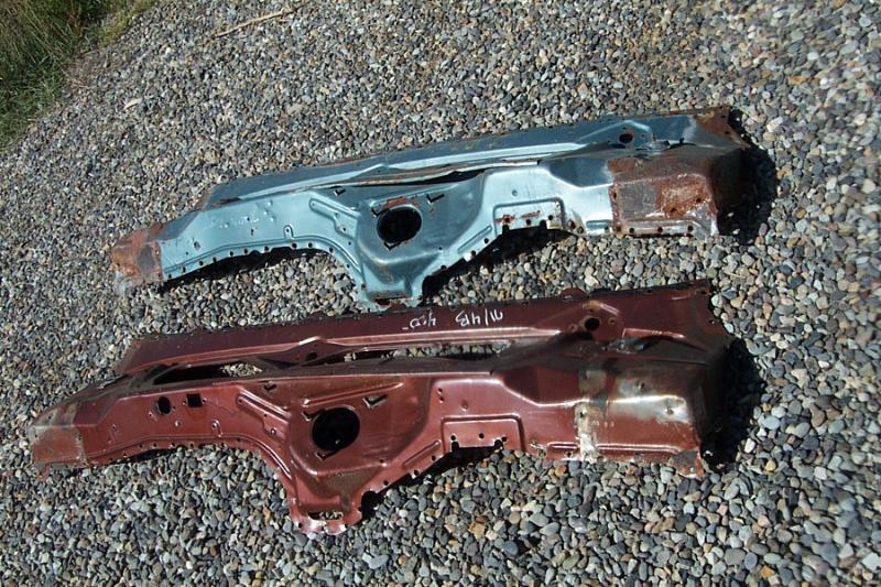

I carry nice originals for 71-4B. AMD doesn't make them. E-body is different.

wondering what could be the difference between E and B body cowl panels
BTW 74 Bs got a VERY SMALL DIFFERENCE with earliers ;) LOL
Look at the area where the hinge folds down.
There is a recess on the B body panel that is not there on the E version.
Does this affect the hood closure?
The obvious difference is the square versus D shaped large hole on the top, but that looks to be only cosmetic.
