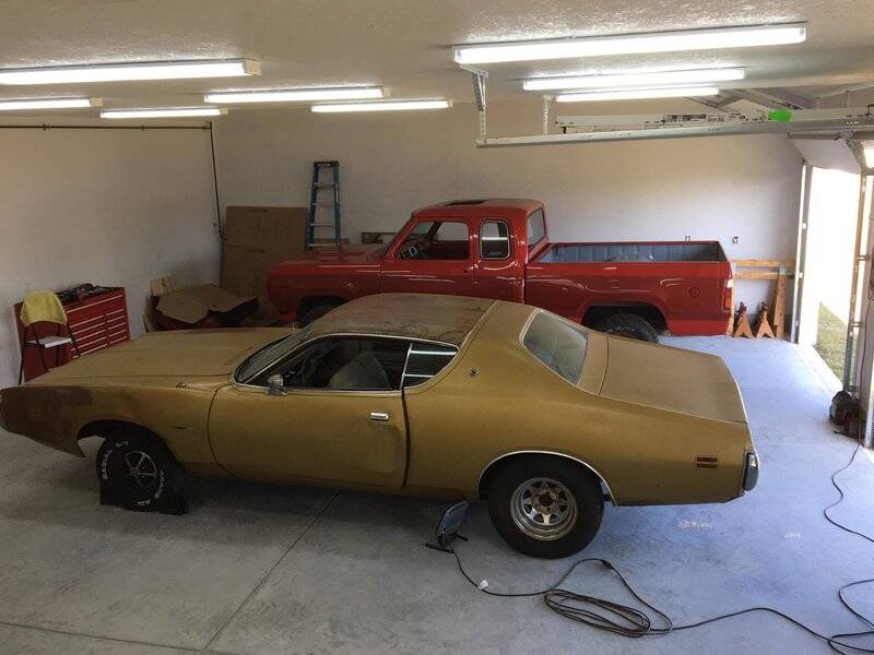

I bought this car back in 2018 and its sat on the side lines until I finished my Power Wagon Earlier this year. I love 71's and have a ton of spare parts for these so its time I put them on a car!
It will keep the SE trim cause I think it has class and not just another clone.
Its a numbers matching 383 N code Auto, but that's all out the window. The plan is 440 4-speed 3.55 rear. Its also gold with the gold/cream colored interior so that's out the window too.

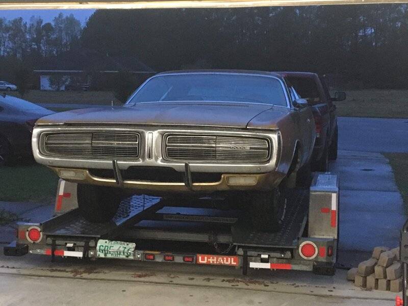

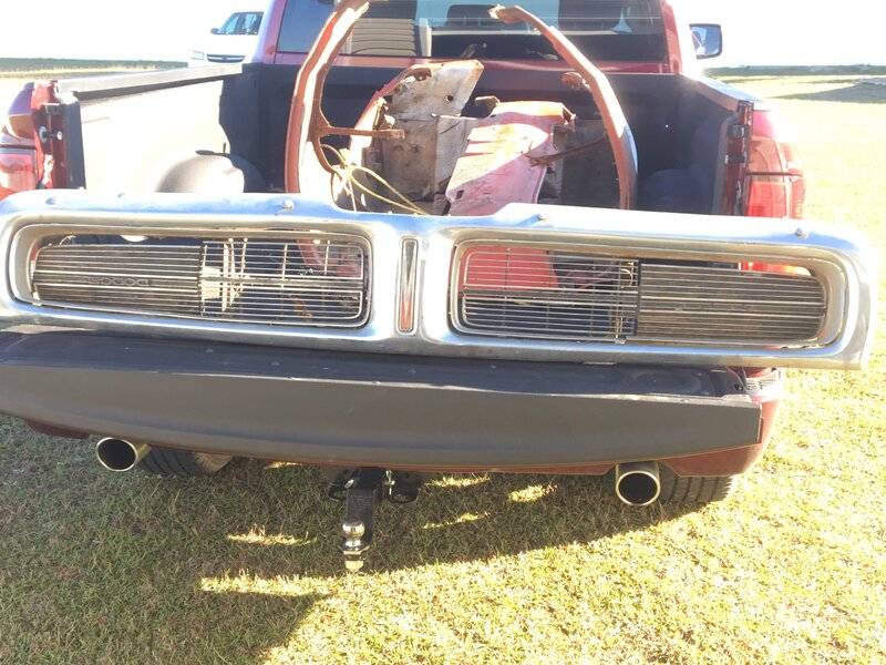

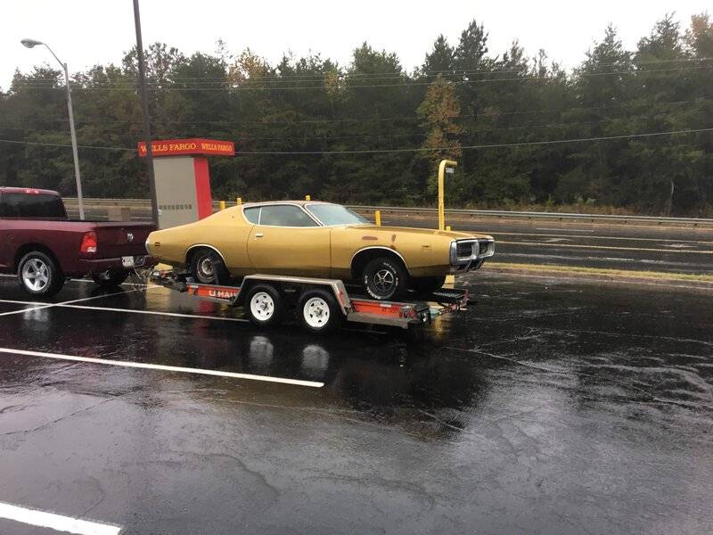

Couple pics the day I drug it home. The engine block and heads were in the trunk. LOL

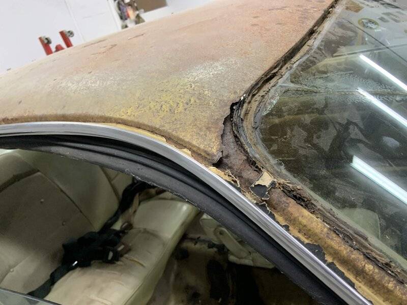

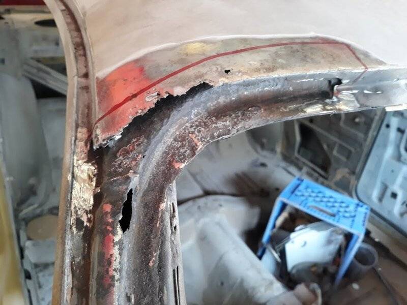

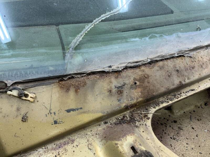

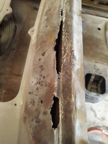

Started tearing it down in February and, yay! Discovered rust under all the windshield trim on the cowl. Going to need some work here.

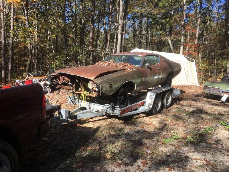

Since I already had a ton of parts for this build why not drag home a parts car? Lots of good stuff on this one for $1500
Yeah that was a bonus! The best part of the parts car was the complete black interior including factory leather buckets. I am on the fence on going with leather or cloth for the build. Surprisingly leather is cheaper than cloth. My original plan was hounds tooth cloth which I have that I bought a few years ago for a 73, but since bought a 74 Rallye I will use those covers on that. That's a whole different project thread.

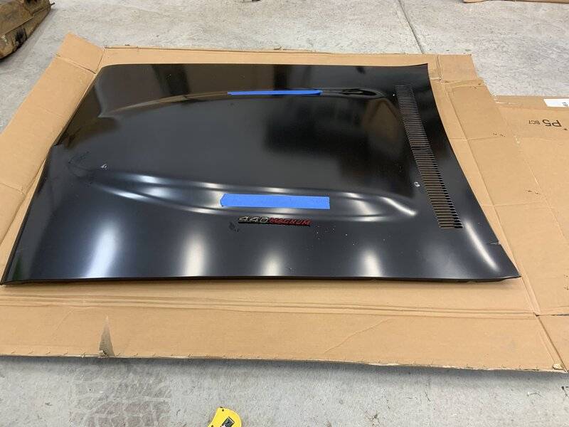

Could you get a option factory Ramcharger hood on a 71 SE ?
I am going with the standard power bulge with this one.
I just pulled out the sales codes
Looks like on a 1971 SE the Ram Charger Hood was not an available option
Option only on the R/Ts and Bees
That bulge hood will look Awesome

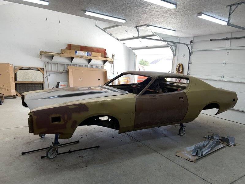

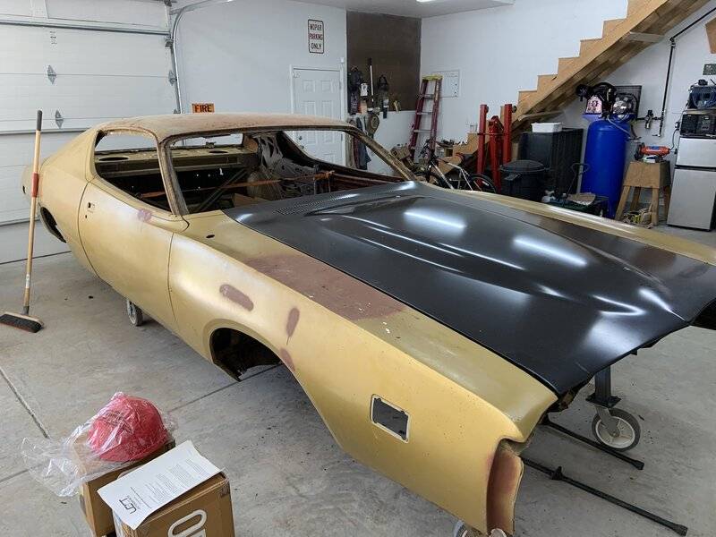

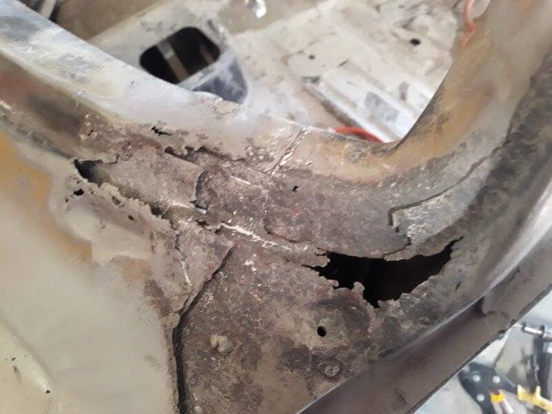

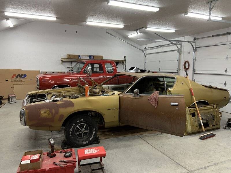

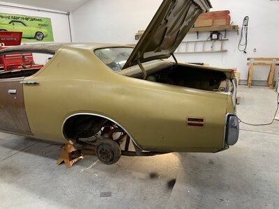

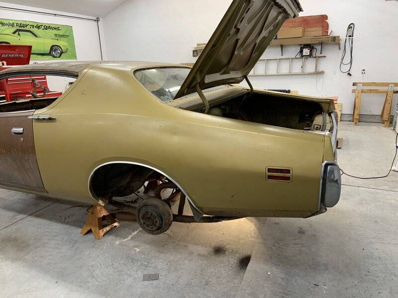

Word was it spun a bearing back in the 80s and the engine removed and taken apart and that's how it sat. Has some damage on the drivers side. The door will be replaced with one off the parts car. The fender will be fixed. Found more rust on the cowl.
I really like the early style pin stripe used so that will get reproduced.

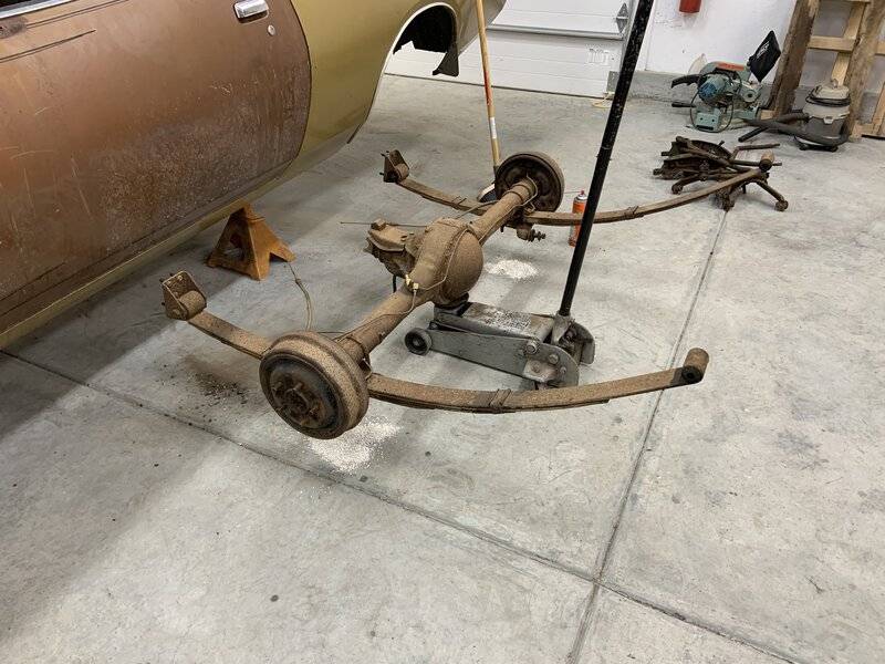

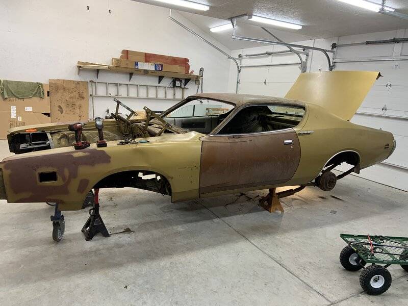

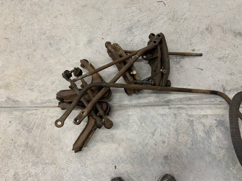

Installed rebuilt door hinged I had stashed away and the new drivers door while loaded. Then the suspension came out and got it on dollies.

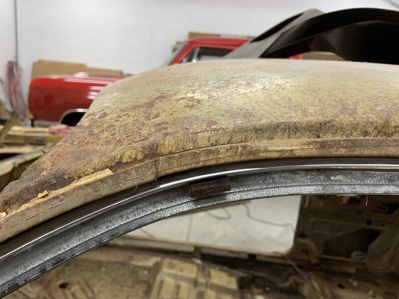

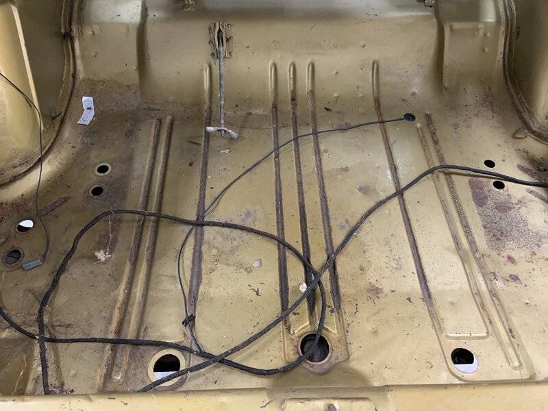

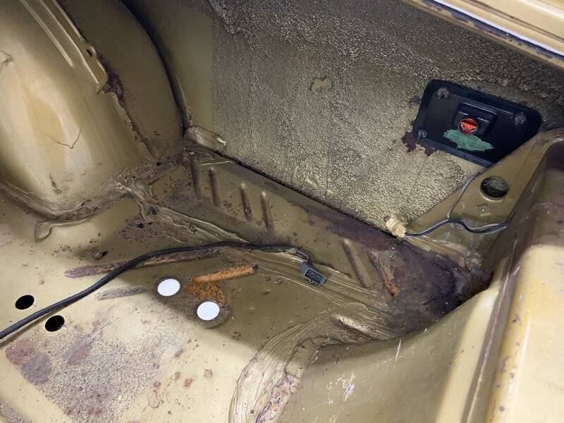

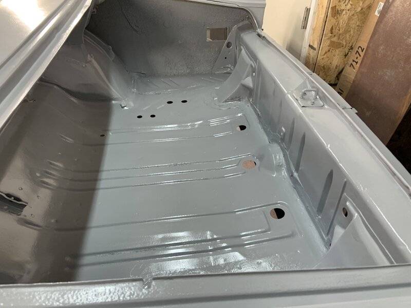

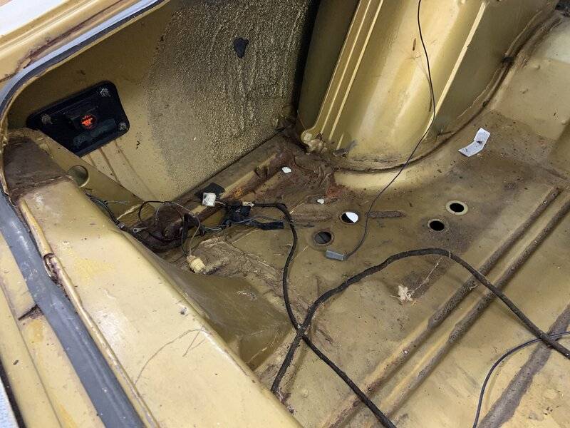

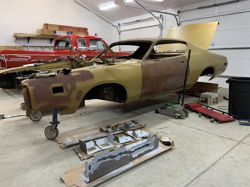

Floors and trunk are clean! but that vinyl top left a mess.
Here it is completely gutted. I measured and drilled the emblem holes for the hood and fitted it. Installed the 4-speed hump and buddy seat brackets, then a good coat of SPI epoxy in the interior and trunk.
Great work, love what you have done so far. I am shocked you had so little rust on your pans. Cost me almost $3K to fix all my rust issues and it wasn't even that bad besides the trunk.

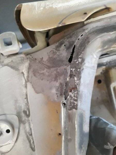

My rust is all in the cowl and a-pillers which was ugly once reveled.
