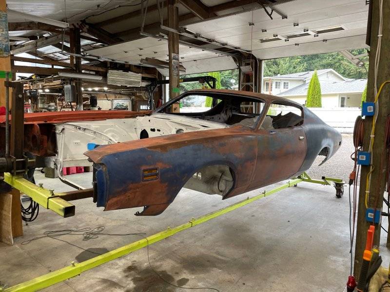

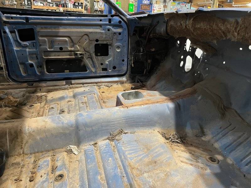

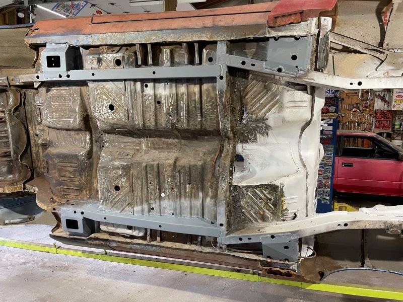

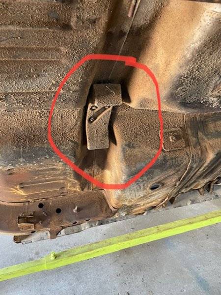

I hope to begin work tomorrow on the car, I will install the subframe connectors and torque boxes then move on to some body repair. I had to get my welding/fab table sorted out today and tomorrow I have to adjust some pushrods in my buddy's hot rod but then onto the Charger
70chall440
12:11 AM
Feb 11, 2018
3,954
5,579
Yelm, Washington

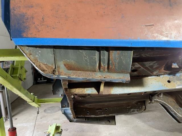

Finally began work on the car in earnest, started cleaning the floor and got the right rear torque box in.

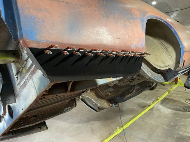

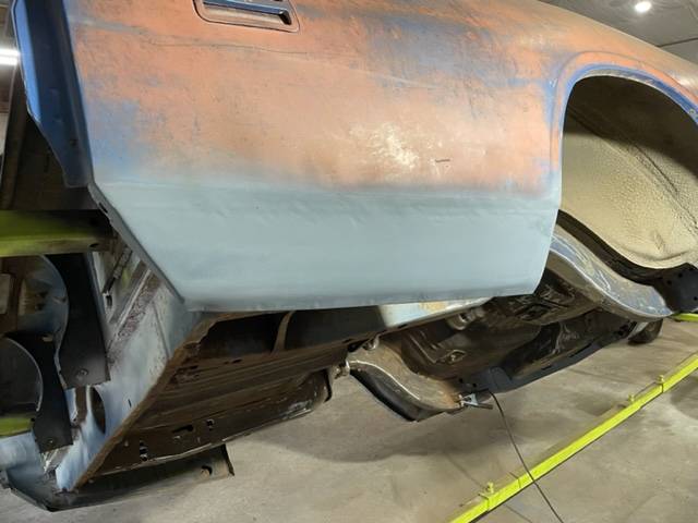

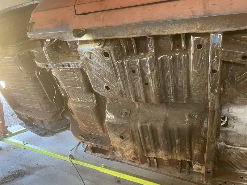

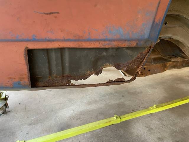

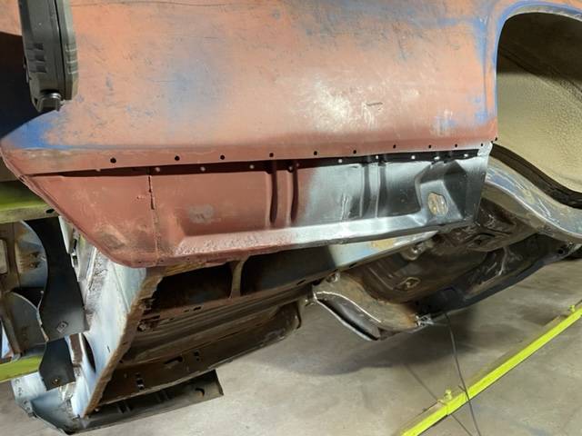

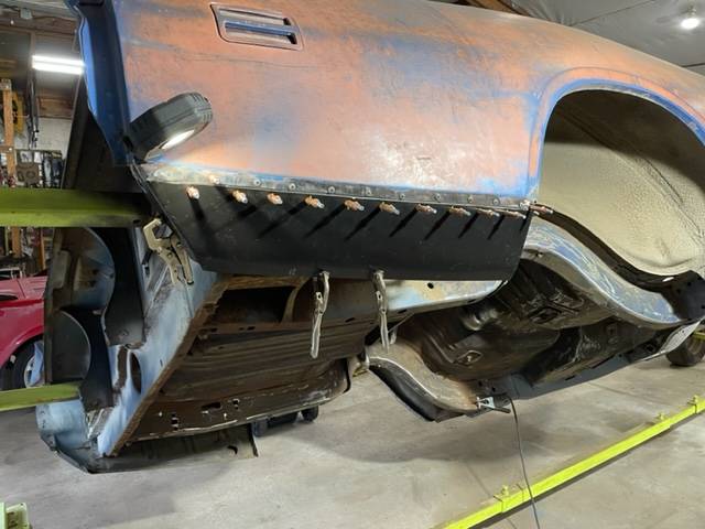

Next up is some body repair, I need to fix some pin holes in the drivers side floor pan and need a couple of patch panels on the rear lower quarter panel.
In case anyone is wondering, the bottom of the car is going to get some bed liner once I am sure I don't need to do anymore fabrication under there.

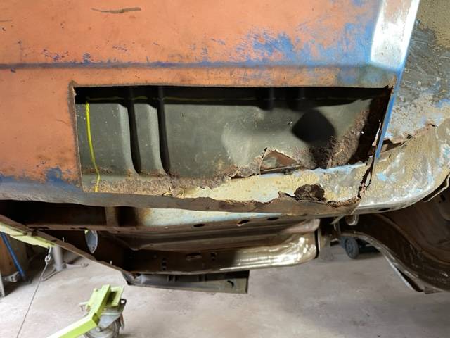

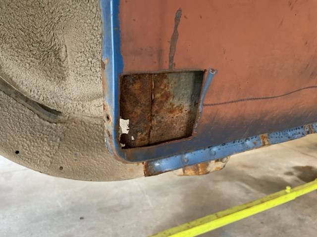

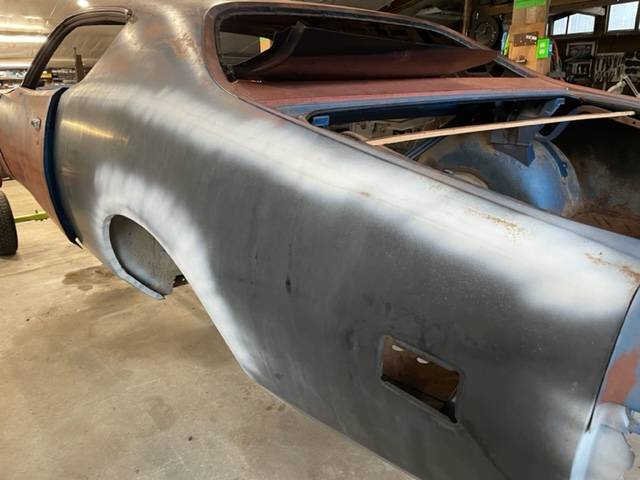

Started on repairing the body, I was able to weld up some pin holes in the drivers side footwell and am now onto the passenger quarter. The PO had cut out what he thought was the the majority of the rust but after stripping it back further discovered more pin holes and weak spots, so I just removed the entire lower quarter and will replace that.
